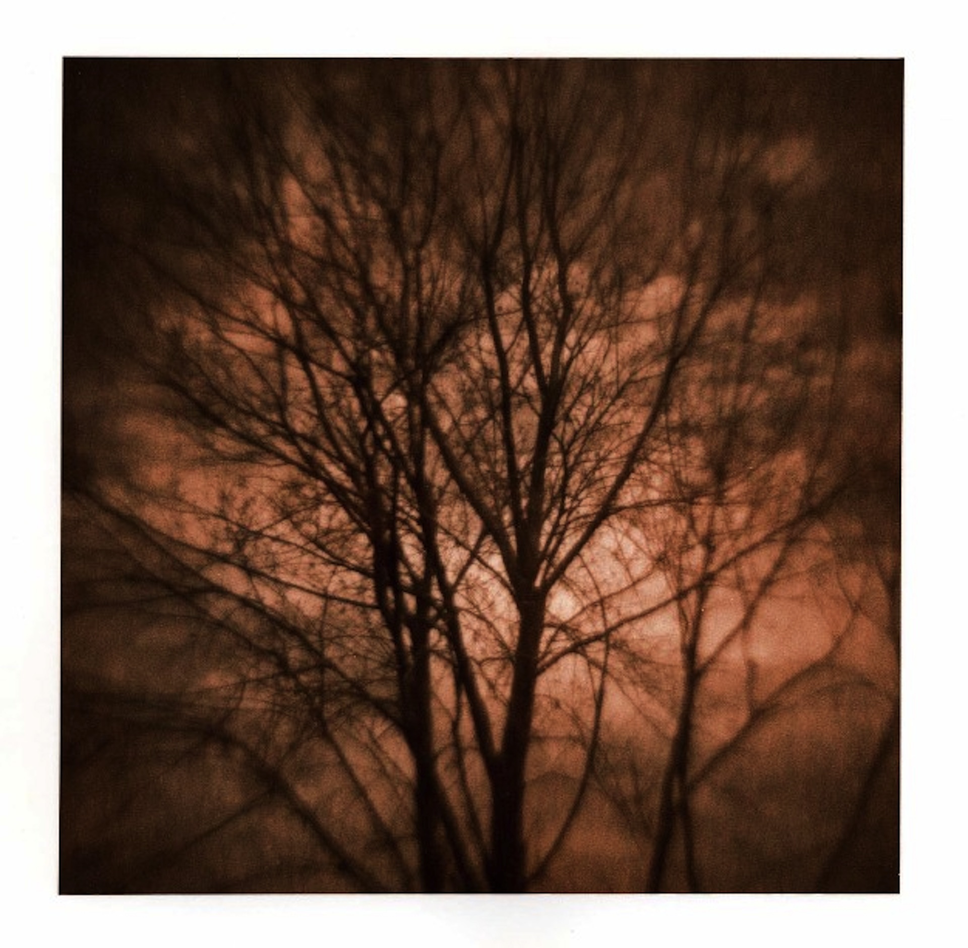

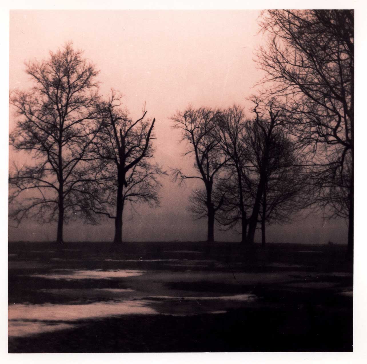

I haven't used M10, but have used the sepia/gold combo. I get light peach colors to almost blazing oranges. One thing to remember is heating the gold will extend its life, as it loses effectiveness.
These were done with that combination:
eddie
Jul 24, 2005
3,258
Northern Vir
Those were both on either Ilford MGIV or MGIVWT. A lot has to do with the processing. It also has to do with the age/effectiveness of the gold. It's also hard to tell how much color a print has taken while it's under the solution. Even though it's clear, you'll need to pull the print occasionally to see the color effect.

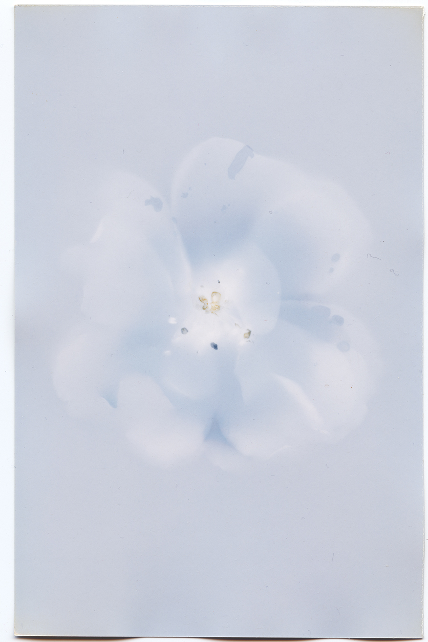

Hi, thanks again for your help. Here's an example of the results I get when I gold tone my lumen prints with the Moersch.
