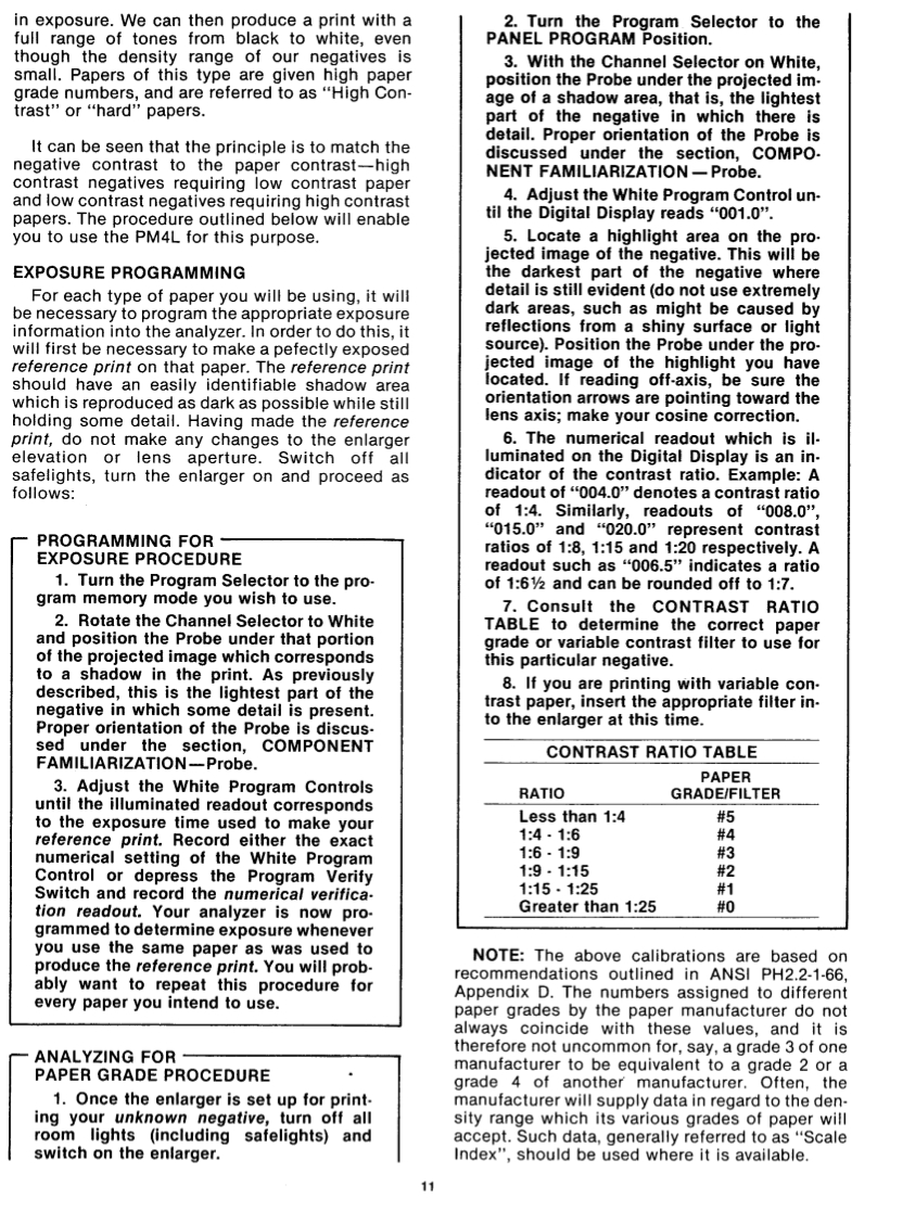

Many, or perhaps most, color analyzers have a gray or b&w channel. This allows them to be used to analyze b&w negatives. I got mine for free.

Ditto the color analyzer on the white channel. Reading the margin for a minimum exposure/maximum black gets you well into the ballpark for more productive test strips (which I still find helpful). So why use a meter and still do test strips? It just gets me a lot closer a lot quicker.

The ratios for paper contrast in this instruction manual can be used with other analyzers.
