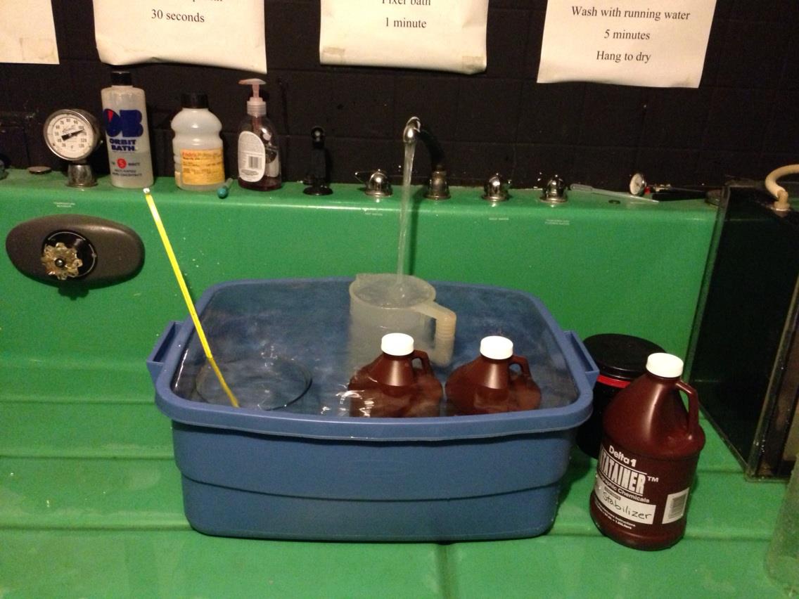

If you decide to go with the tub setup [nothing wrong with it] do yourself a favour; buy a calibrated thermometer for such temperatures (true readings are important), and a decent thermostatized heather. Nova had one [novatronic] which althought seems expensive compared with a fish tank one, does its job with enough accuracy for photo processes without headaches out of the box, being somewhat thoughter than fish ones; also, price isn't over the roof. Given current prices of film and chemicals, I find those justified.
I shied away from color processing for a long time thinking it was "difficult".
I don't have room for a dark room so I use film changing bags, a scanner or two, and process my film in my kitchen.
To do color I actually use a shallow baking pan that fits over my sink and run warm water in to it. I put my developer and blix bottles as well as my processing tank in the baking pan.
I put a thermometer in the pan and bring the temperature up. I then leave the water on slightly higher than the temperature I need and move the faucet in to our out of place as need be to keep the temperature correct. I can maintain +- 1 degree of my target temperature this way.
I'm actually beginning to prefer color processing over black & white. It's quicker and I think it's just as easy to do.

I use a Paterson tank and tempered water bath (in a small portable cooler). I keep the water bath at about 118F, give or take a few degrees. I pour the developer (at about 101F) into the tank and immediately put the tank into the water bath. The level of the water bath should be about the same as the full tank, so that it won't float. Anyway, I do twirl stick agitation for the first 30 seconds, then put the lid on the tank. I invert every fifteen seconds -- quickly. That is, the tank comes out and gets two very quick inversions (with about a quarter turn between) before going back into the water bath. This goes on for the duration of the developing time. Every fourth inversion stop or so, I might end with a quick tap to release any air bubbles on the film (as in black and white), though things happen so fast with C-41 developing, I'm not sure how necessary this is.
118F might sound hot, but with inversions taking between two and three seconds, the tank is out of the water bath about 20% of the time. In any case, it's after regular and repeated test runs (with water) that I came up with this process. I'm measureing the temperature in the middle and at the end of the developing time. This is with 500ml of developer and an ambient temperature of about 68F.

I keep the tank in the water bath during all tempered steps. I fill it until the chemicals are about halfway up the funnel so that the film is submerged but there's still some room. With the rubber lid on it will float upright, which I like, and I take it out briefly for inversions every 30s. Better temperature control can be achieved by filling it all the way up so that the tank sinks, but my tanks are leaky at times so I avoid this.
If you're going to have the tank float you also have the option of using the little spindle to agitate it so that you don't even have to take the tank out. Entirely up to you.

I went the tub of water route at first, but I found I was always so nervous about the temperature being "just right" that it sort of spoiled the fun of the process. (I never liked fighting the off-temperature crossover effects.) So, I engineered a simple and cheap tempered water bath out of stuff you can get easily on eb*y and local stores. Here's a link to a post I made on APUG that describes this: (there was a url link here which no longer exists)
While some will say this is overkill, I feel it really helps me relax and enjoy the process, not worrying about temperatures. Also, it gives me enough space so I can do processes like dip and dunk with lights out, not having to worry about monitoring temperatures.
That said, the tub of hot water did work fine for me until I built this. Color processing is sensitive to temperature, but it ain't brain surgery. Go for it!
