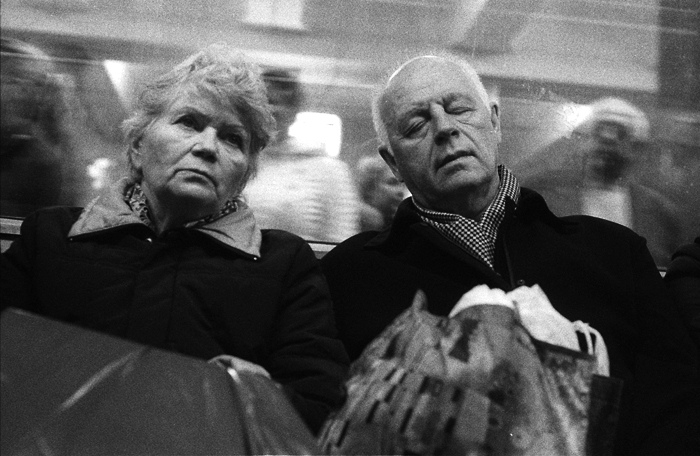

Also, I’ll show you a picture or two to give you an idea of my project. It's from the subway in Moscow, and I wish to print 30 pictures or so:
thanks
/Erik
