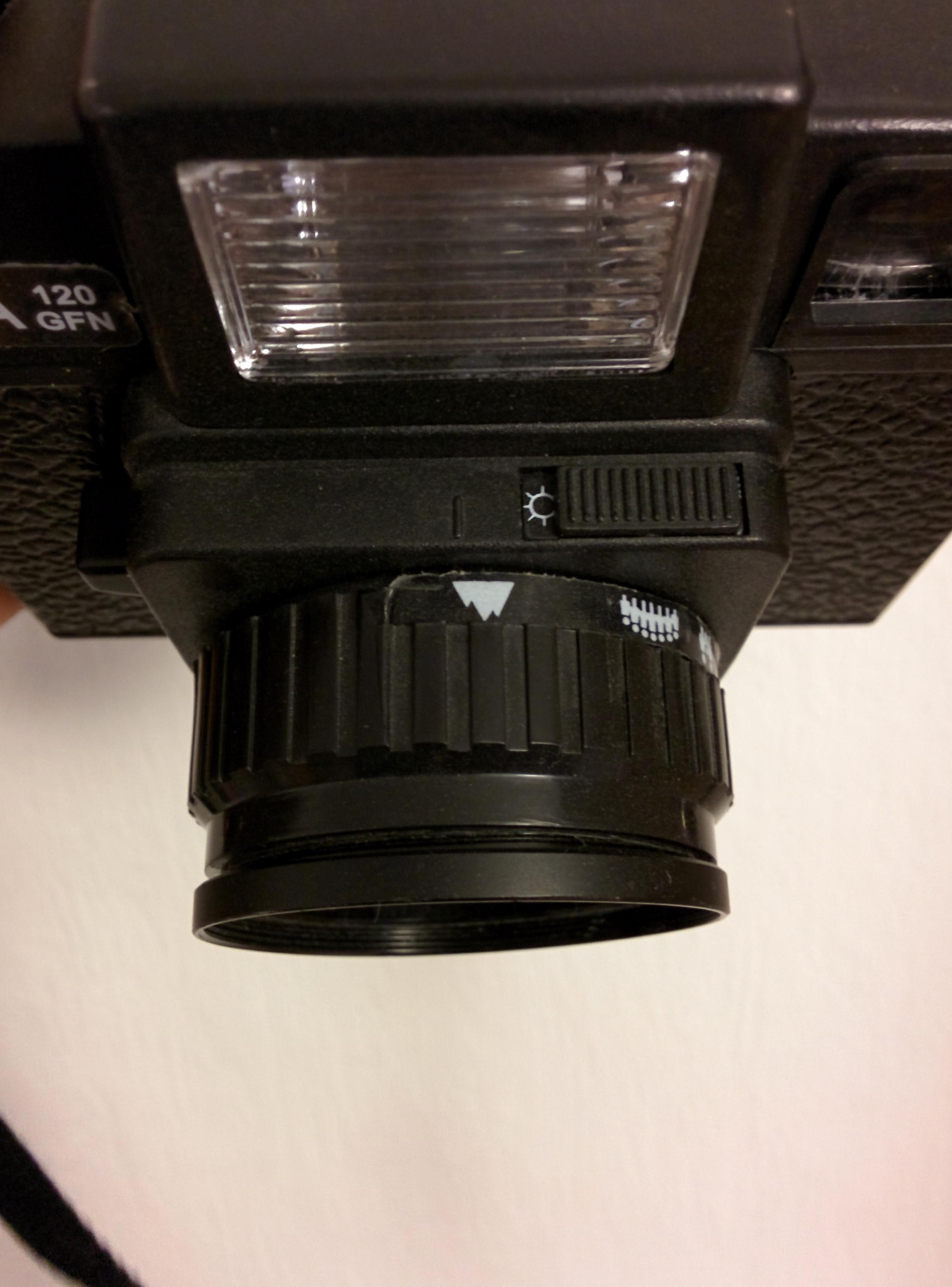

Set you lens to landscape icon like here in Holga 120 GFN.
