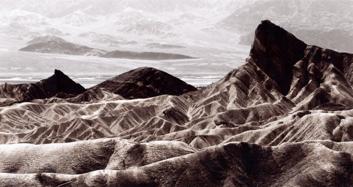

I never tried Ian's method. I wish I would have! I used to do selective toning/double toning (I don't know what to call it) back a long time ago. IIRC I used something called Maskoid which was red. I don't think the kind I used is made anymore, but the Fotospeed product above sounds like it. You can also use the masking solution that water color artists use. IIRC it is a latex based product. There is also (or used to be) sheet material you can get that will protect large areas. You can do some neat things with masking, although it is very time consuming
