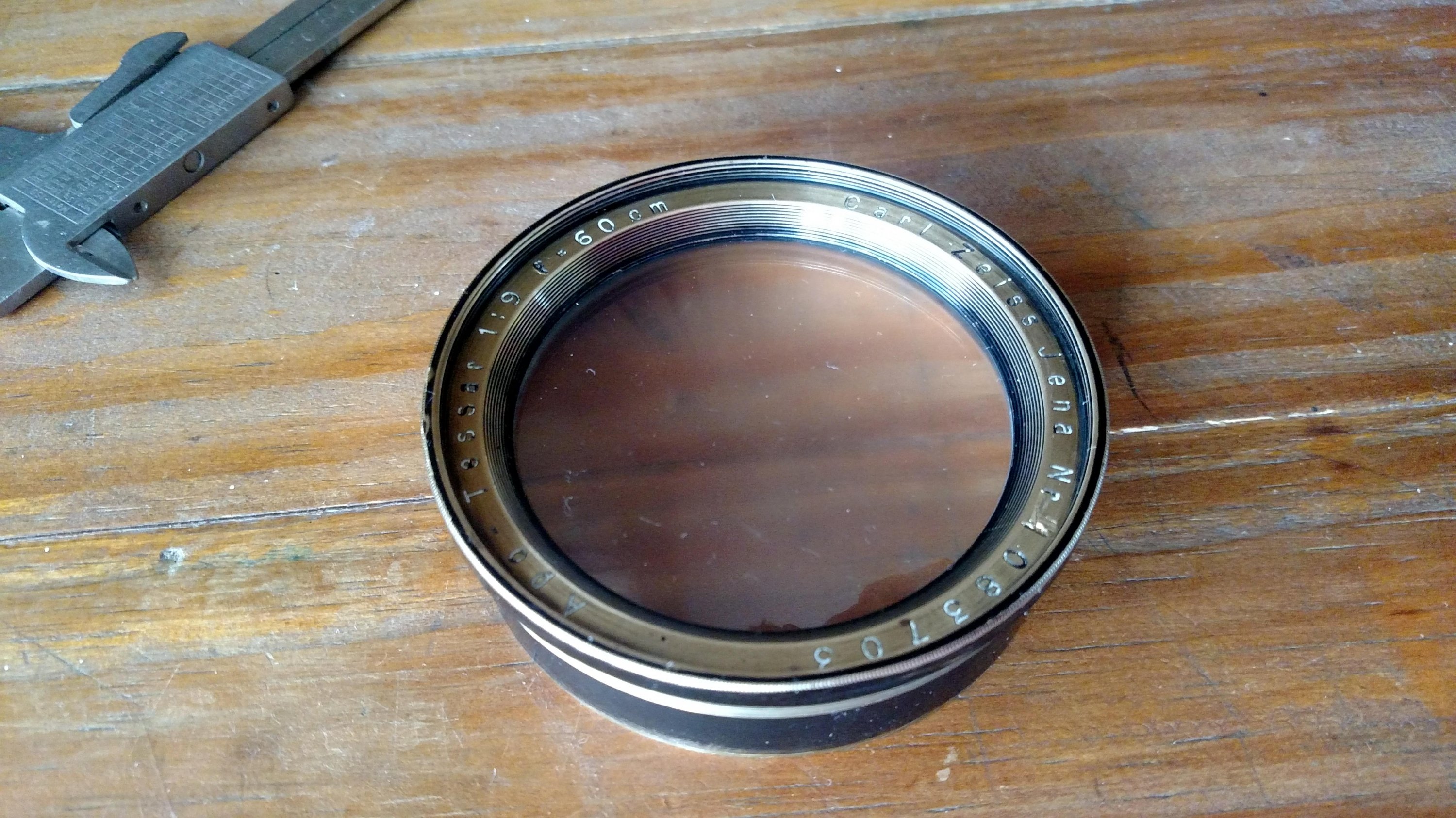

Algo después
Oct 26, 2020
243
Ecuador- Argentina
Another method is to heat an oven to 175°F-225°F, turn the oven off, place the cells in the center of the oven, close the door and leave for 15 to 30 minutes. Sometimes such heating will "fix" the Balsam and it will clear upon complete cooling.
a dummiest question: what if I can´t separate this part.
Would it work to put all this part in the oven?
Dan Fromm
Mar 23, 2005
6,941
Curses! Mr. Later, your photo shows an Apo Tessar front cell. It contains two singlets. They're not cemented together. The CZJ Tessar front cells that I've taken apart have a retaining ring at the rear that should unscrew to release the rear singlet. Make sure that the elements are oriented correctly when you reassemble.

Algo después
Oct 26, 2020
243
Ecuador- Argentina
yes Indeed Dan, I feel that the lens knows that it is in the operating room BUT WITHOUT A SURGEON :blink:
