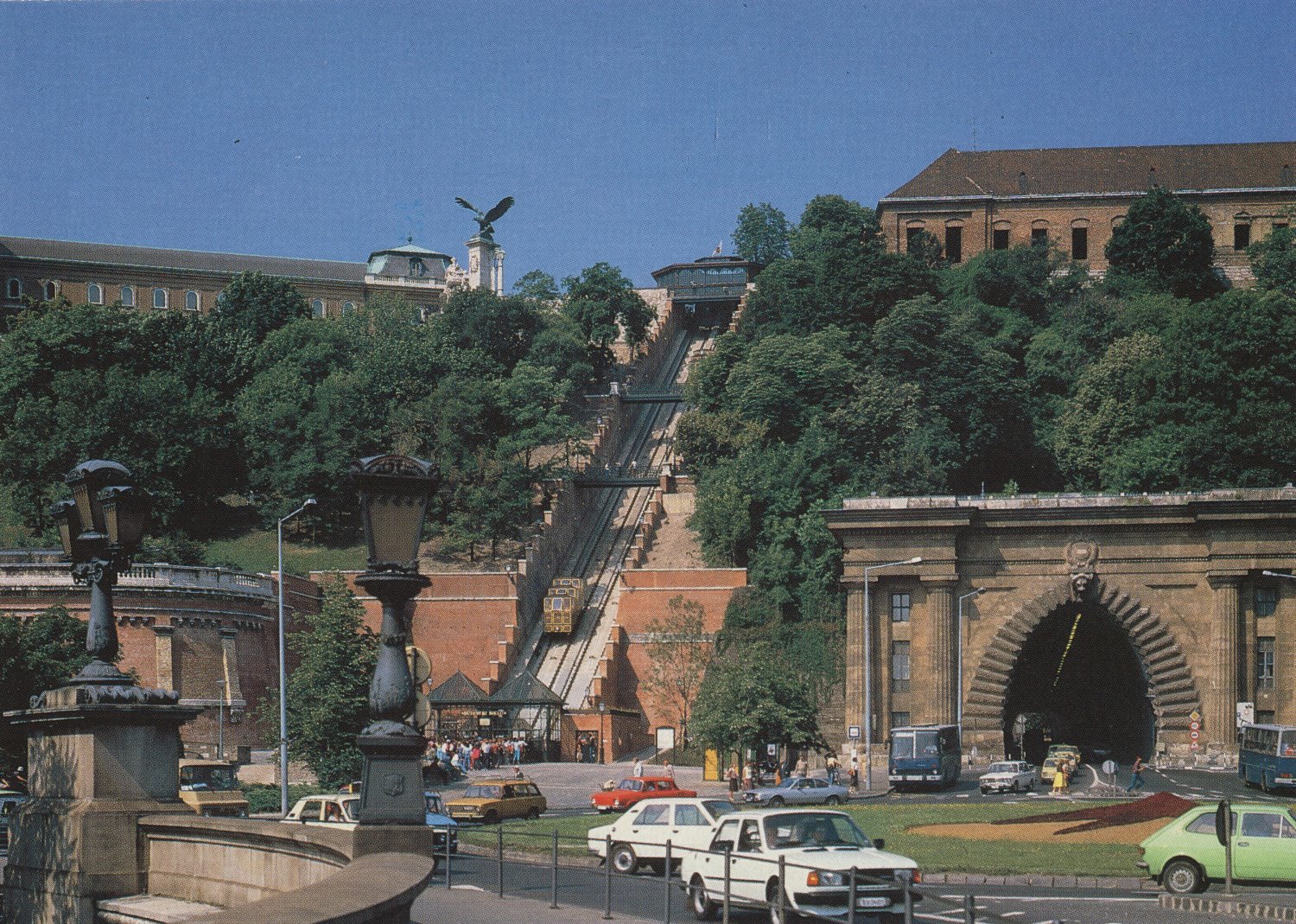

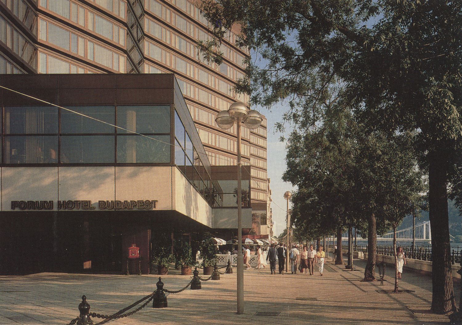

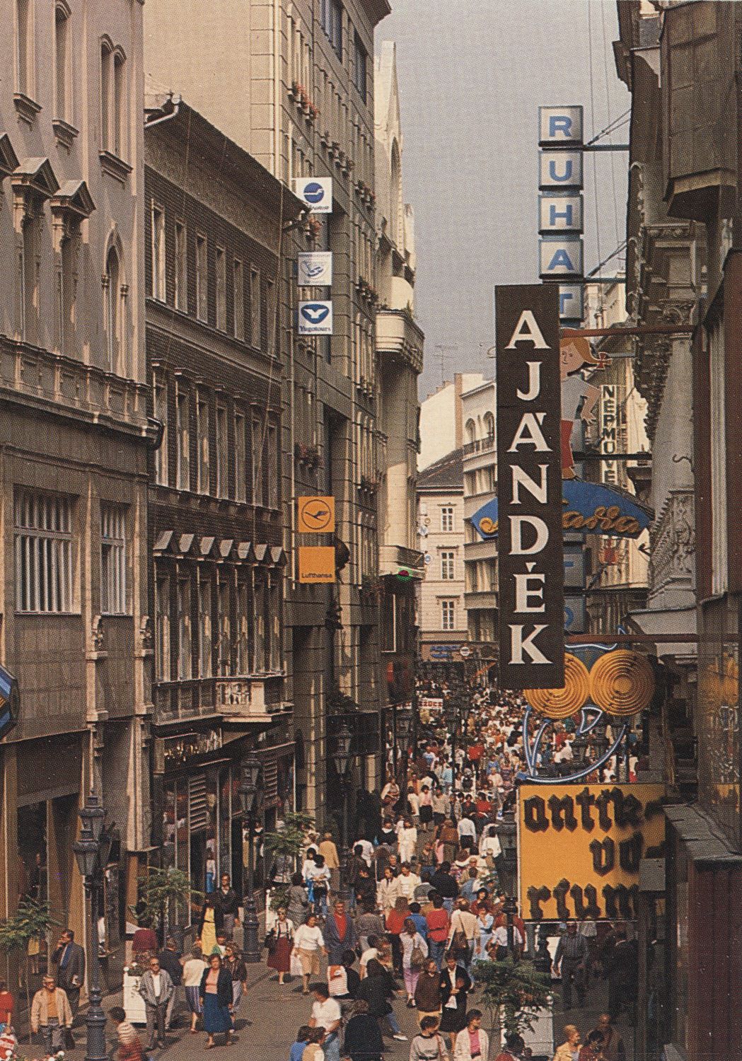

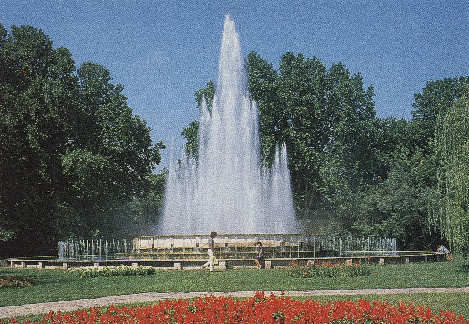

I've found a dozen of these 1980s postcards of Budapest landmarks at home, had them scanned, and I'm loving the colours and vintage feel of these photographs.
How could I reach the colours like on these samples, using (35mm) film stocks available today? Is it even possible to come close to this colour palette? I would assume these were shot on transparency film, whatever stocks were available in Hungary at the time (for this reason I think Kodachrome is unlikely).
Would any of today's slide film be able to give back this atmosphere/palette? I also have lots of color correction and compensating filters to play around with, but don't really know where to start. Or perhaps I should try colour negative film? I have an upcoming trip to Budapest and thought I'd try if I could take some images that have the same vintage feel. I have Provia, Velvia 50, Velvia 100, and E100 in my fridge as well as some colour negative film.
I'm still quite a beginner in photography, and I'd be grateful for any and all advice and suggestions how I can go about it.

No currently manufactured slide film will look like this. The original slides in all likelihood didn't quite look like those postcards, in fact.
What you're seeing is fairly low saturation, low contrast and low color purity (i.e. crossed over). #1 and #3 have a strong yellow cast, #2 has a strong cyan cast; #4 is fairly neutral, but low contrast.
Of course, as long as you scan your film, it doesn't matter too much what you start out with; you can adjust the colors to taste in digital post-processing. If I wanted to approximate these results and I had to use film (left to my own devices, I'd just shoot digital), I'd shoot on something like Kodak ProImage 100. If I were hard-pressed to also print it optically, I'd print it on plain-Jane Fuji Crystal Archive Lustre (no Supreme, DPII etc.) and maybe use pre-flashing to recreate the color casts and reduce contrast.
Keep in mind that when looking at these images, you're looking at the output of a long imaging chain:
* Choice of film stock
* Choice of shooting conditions, time of day, exposure
* Development, although this would likely have been 'by the book'
* Choices made when making the color separations (massive influence!!)
* Choices in screening for printing
* Choices in printing ink/pigment set
* Aging of pigments over time before these cards got to you (again, a big influence)
* Choices in digital display (e.g. these could have been presented with a lot more 'punch')
All considered, the choice of film is a minor factor in the bigger scheme of things.

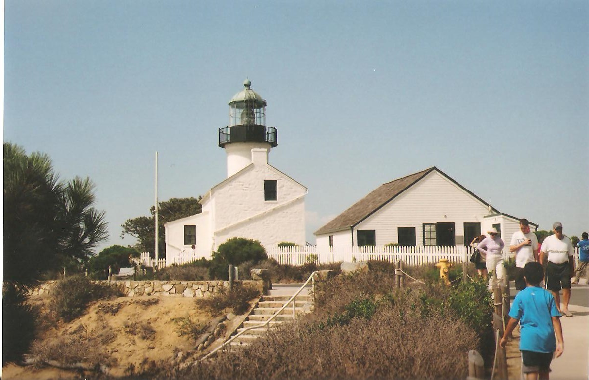

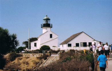

Here is an example of Kodak ColorPlus, which I think will get you as close as you can without post-processing. I used a Kodak Retina IIIc, 50 mm lens, and (I think) metered with a Gossen LunaPro.

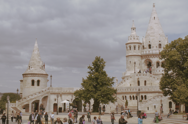

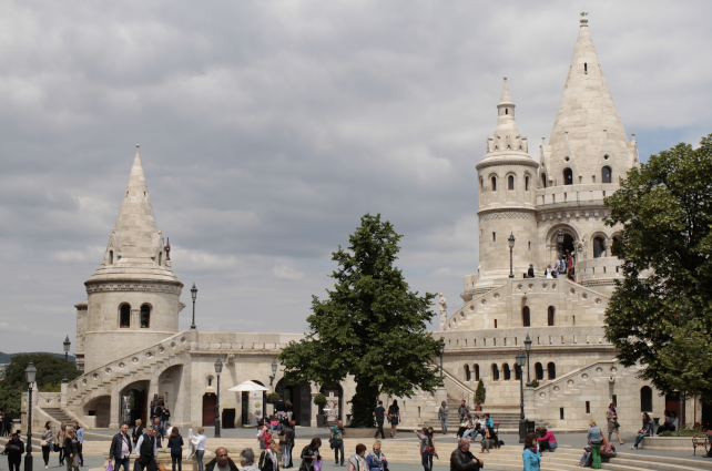

I've always romanticized old slide films as a way of connecting to the look and atmosphere of bygone times which I'm so fond of aesthetically.
The issue is that the 'vintage look' that we associate with 1960s-1980s color materials is based largely on how these materials look today - with all the color shifts that happened over time. And even while we are aware of this problem at some level, we still can't help but thinking of the 1970s as tan- or magenta-colored, and photographic technology of those days limited to such "vintage palettes". It looks vintage because by now, it has become vintage and has degraded.
Take these examples:

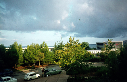

There was maybe a year between these images, if that. They're both from around 1973-1974. If you load some modern Ektachrome into your camera and shoot out of a window in a rather dull place somewhere in the Adriatic at around 7pm some day late August after a storm has cleared, you may get something quite close to the first image above. And I'm pretty sure that the second slide looked perfectly natural color-wise when it was new, just the same. The problem is - I wasn't there in 1974 when that slide came back from the lab, and even if I had, how could I ever accurately recall what the colors looked like?
So there's an inescapable bias in how we experience the past when it comes to photos. Some of the 'vintageness' that we see really is the contrast and color rendition of the film we had back then. But a lot of it is just poor storage, humidity and fungus doing their work.
I really like the colours of this, very similar to my postcards.
Yes, although I'd like to point out that it's not necessarily inherent to the film.
You can balance it pretty much any way you like, especially digitally. Now it looks like a 1994 postcard...

Sure, digital post processing can get you many different looks but remember that this is: Analog Workflow Forums (100% Analog/Traditional) Darkroom Color: Film, Paper, and Chemistry :smile:
The image I posted was a "straight scan", whatever that really means, done by company which processed the film, The Darkroom in California USA.

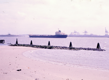

It was an extreme example to show you can make whatever photo look like an old and faded postcard. I could have made it a lot more subtle, and in fact I initially did, but I found it too...subtle.
the very pinkish one of a ship
That's a very badly degraded slide. Not an offset printed postcard.
So yes, they both look very different. They both illustrated different aspects and I evidently picked extremes to illustrate the point. Otherwise someone might have come along and said something like...
