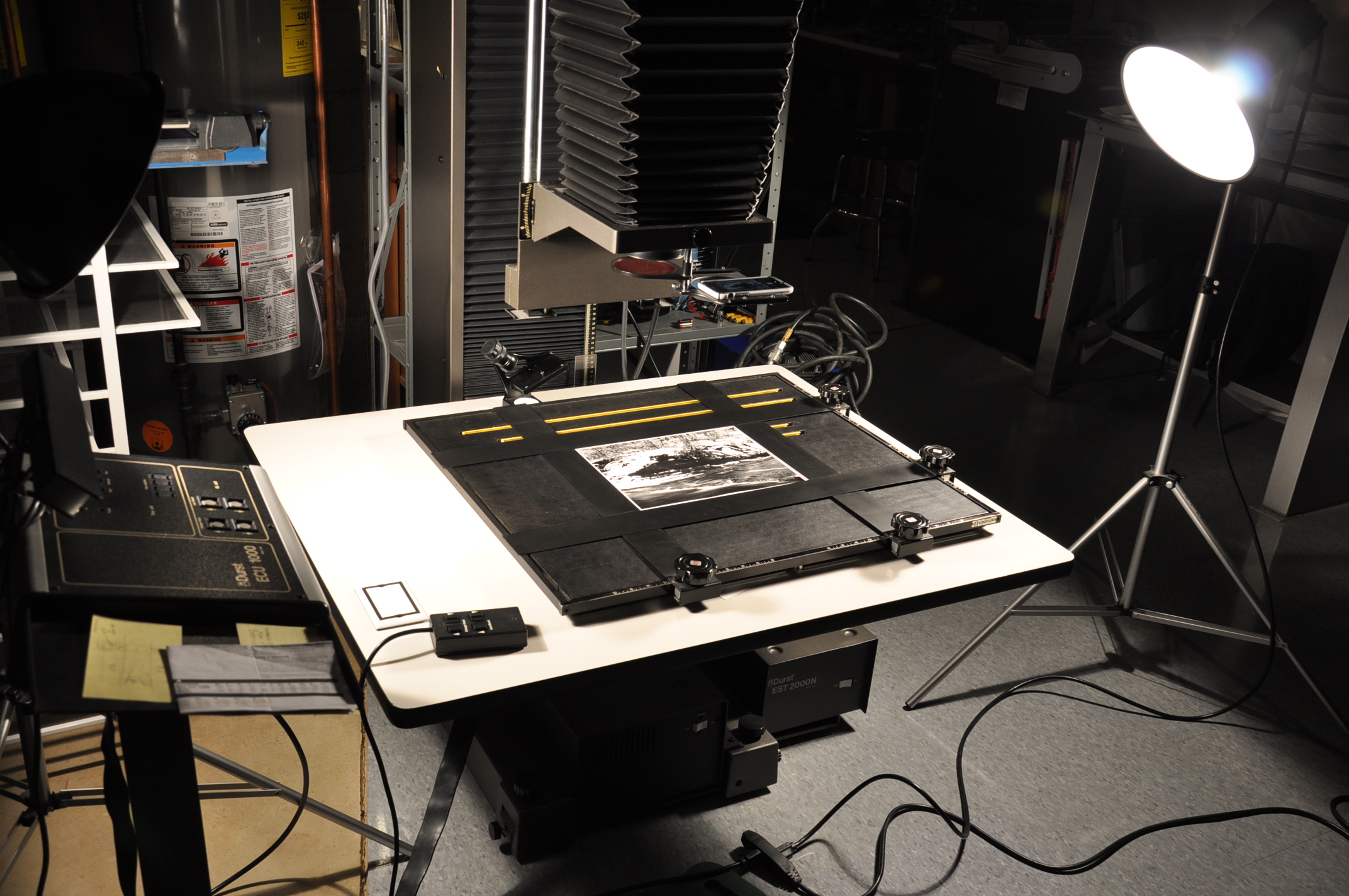

This is the setup I have been using. Here is an example of how I image a 11x14" print. A longer focal length lens would be better, to minimize reflections off the camera face, but this iPhone works pretty well, I don't do this with a DSLR any more. Yes, the iPhone is just sitting on my filter holder.
The resulting image (see below) will satisfy most on-line image sharing duties.

I use my enlarger column with the camera attached and pointing down to the enlarger base with the copy work horizontal, so using a large piece of matt black cardboard with a hole cut in the centre for the camera lens is more manageable.
The large sheets of card sold by Daler Rowney in the UK for making into picture surrounds are ideal.
