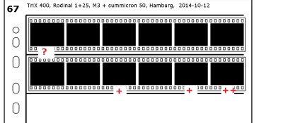

This is how I do it: all negatives are cut in stripes and go in sleeve and in physical folder - every folder has a year number on in. Every negative sleeve has unique number for that year, start from 1 for every year, so that I can also see how many negatives I have shoot on that year. While scanning - folder names are same so that I can easy find negative that correspond to digital scan.
On negative sleeve I put markings like in picture attached: ? mark means maybe it deserves to be printed, + means it should be printed, ++ means it is printed already.
