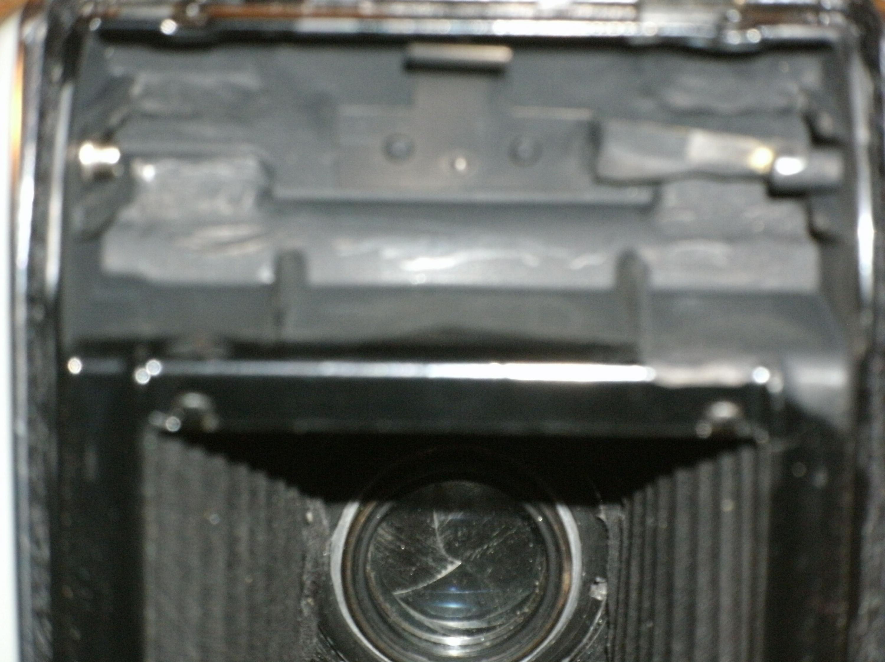

I've done a couple mods for 120. You only need open up the feed side of the camera, leave the take up side alone. The drive pawls on the take up are too small to properly engage a 120 spool, so a 620 spool is needed, plus there is much less work involved since you won't have to grind out that side.
First, remove the back, and tape everything except the area to be modified (this includes the front, top and sides--dust goes everywhere). You must be careful not to touch the tension spring(chrome thingie) and test fit often until you have the bumps shaved down to fit a 120 spool. I use a spool loaded with two strips of backing paper to replicate a full roll of film. The bumps that need shaved are the two on the bottom beside the post that holds the spool, and the two on either side of the spring, also the two at the top that protrude down (where it looks like the spring should continue but doesn't). Do not mess with the two bumps at the top that the upper post is between, as they are needed to lock the spool in place. Sorry, I don't have any photos of any of the procedure to show. If you are interrested, I have two extra Tourist bodies (no lenses) you can have for postage, just in case you have an "oops".

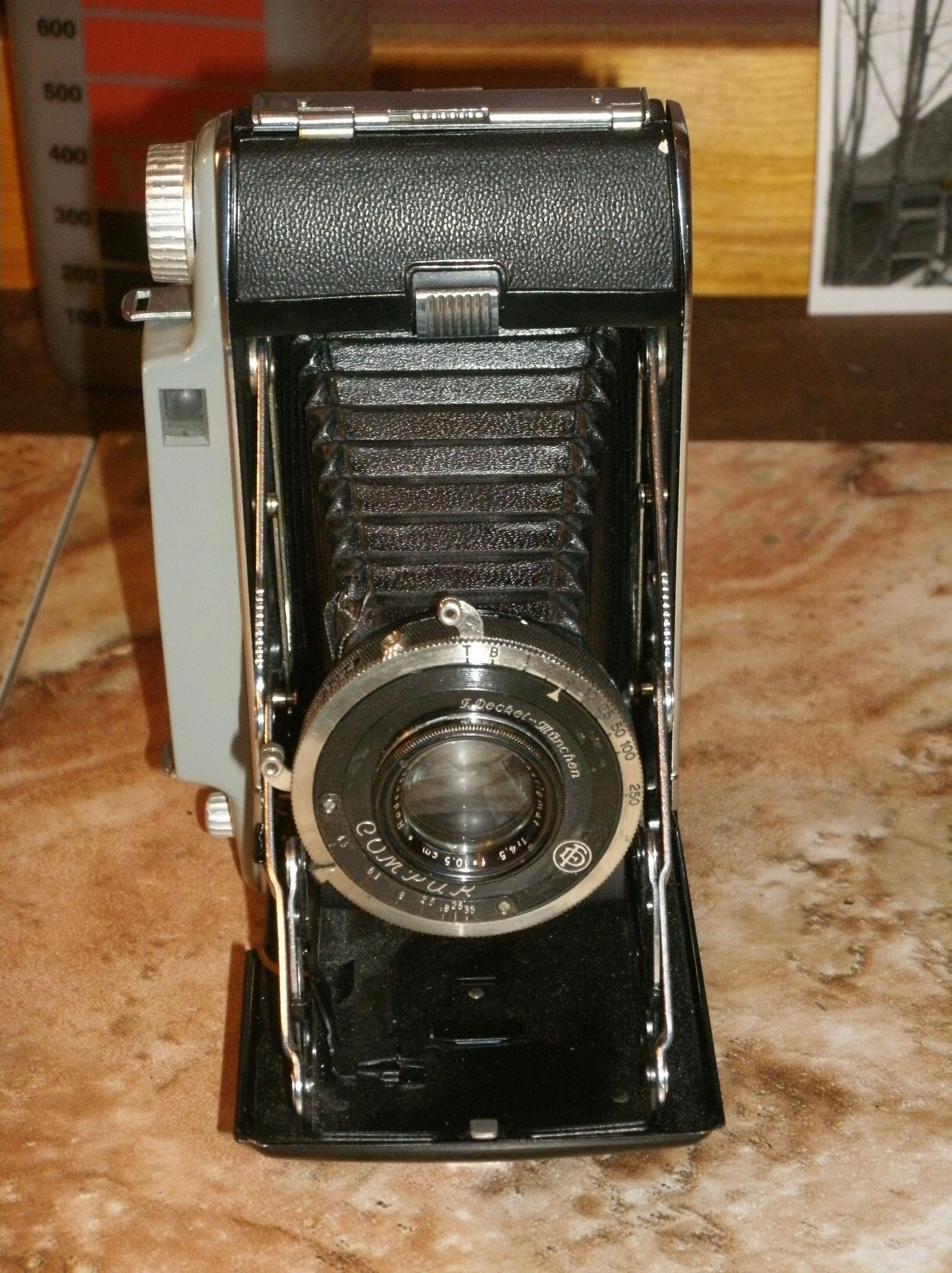

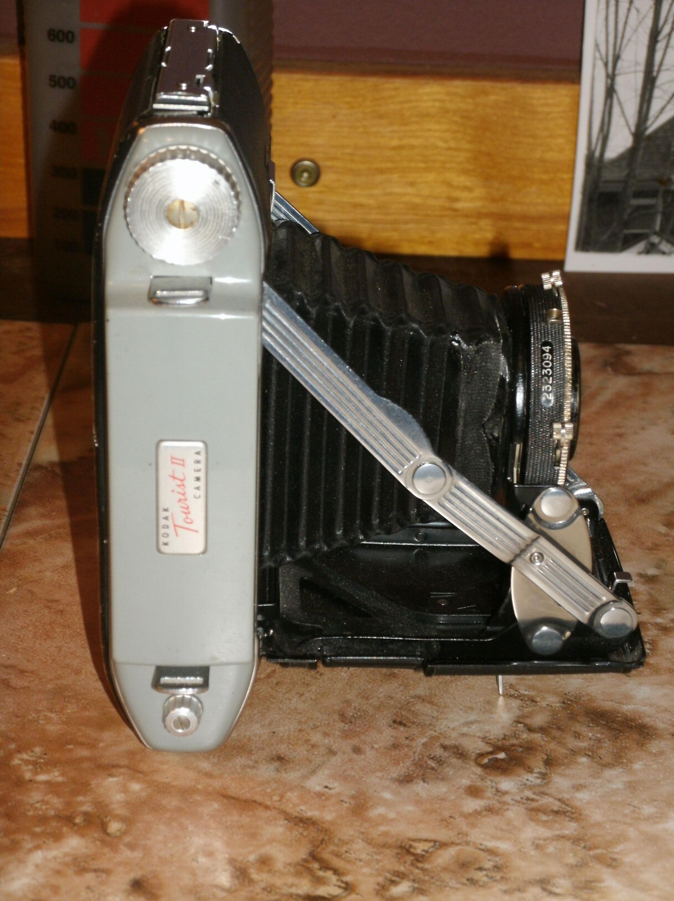

Now I'm going to let you all in on a little secret. The Tourist II doesn't need to be ground out to fit 120 film on the feed side, although it still needs a 620 spool on the take up side. I merely swap the desired lens/shutter from the Tourist to it for use.

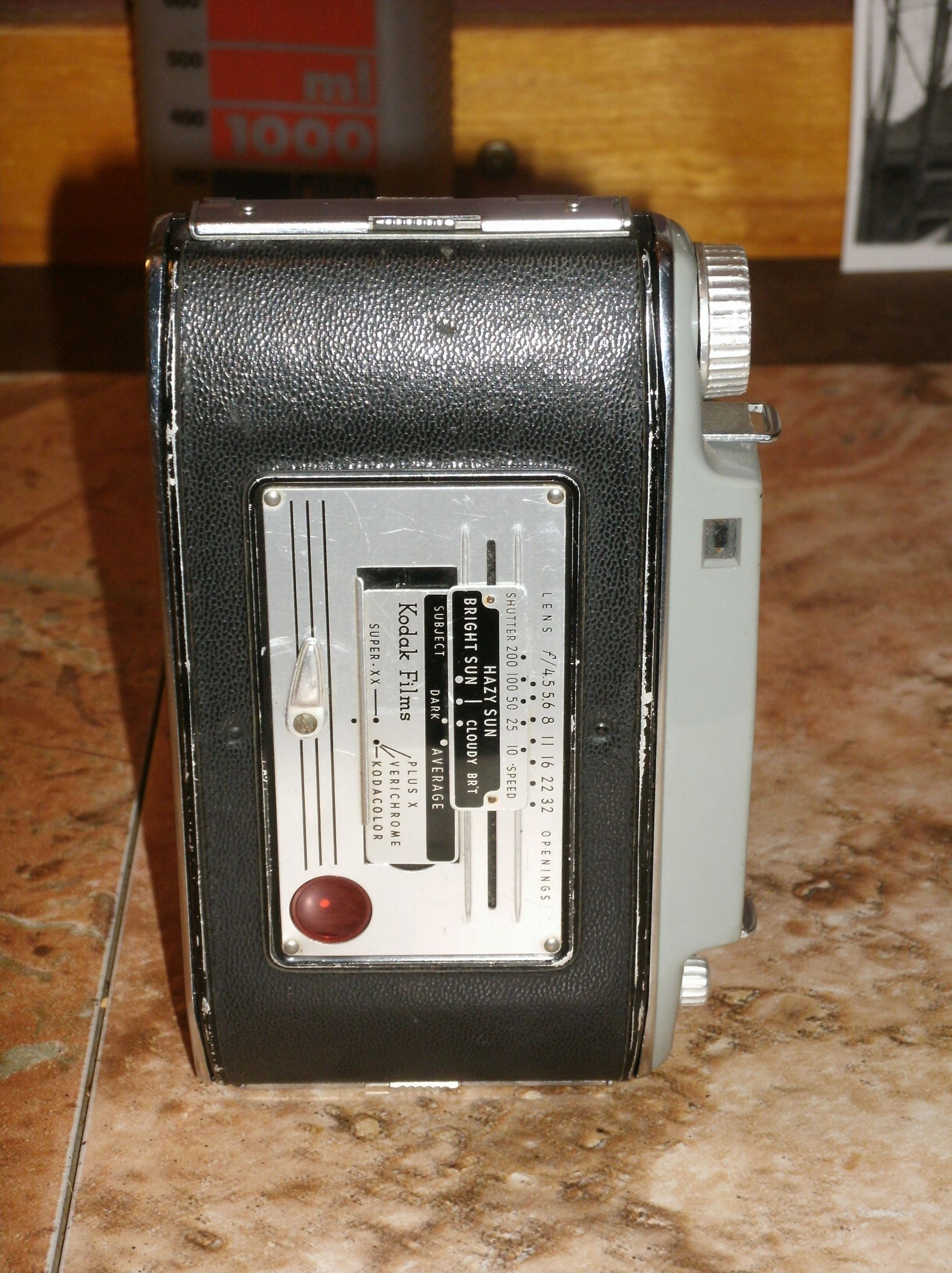

My Franken-Tourist II. No chamber mods, but a Rodenstock 105mm Trinar in a Deckel Compur shutter. It accepts 120 on the feed side but I still have to use a 620 spool for take up. Plus the back from a Tourist because I prefer the self closing ruby window. Whe it's time to advance the film, just hold the lever down, when you get to the next number, just let it go and it automatically closes, I don't have to remember to do it.
