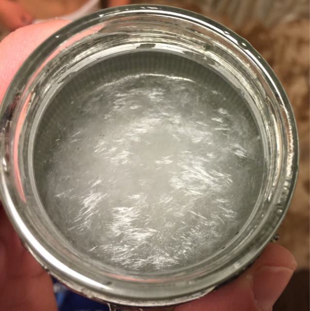

Hello all,
I bought some BZT from the Photographers Formulary and mixed it up in hot water (circa 80Celsius) and stirred until dissolved.
I have since stored it in a glass jar and when I came back to it today I saw it totally returned to its original crystal like form.
What did I do wrong?
Thanks,
Ben

Hello all,
Thanks,
Ben
What was your ratio of chemical to water for this mix? I have mixed it for 1% or 2% solutions and never encountered any problem. Even at a 20% solution rate I have never seen this. You must have a very high chemical to water ratio????

You need the carbonate to dissolve and keep the Benzotriazole in solution. This is the solution used in Ilford published formulae.

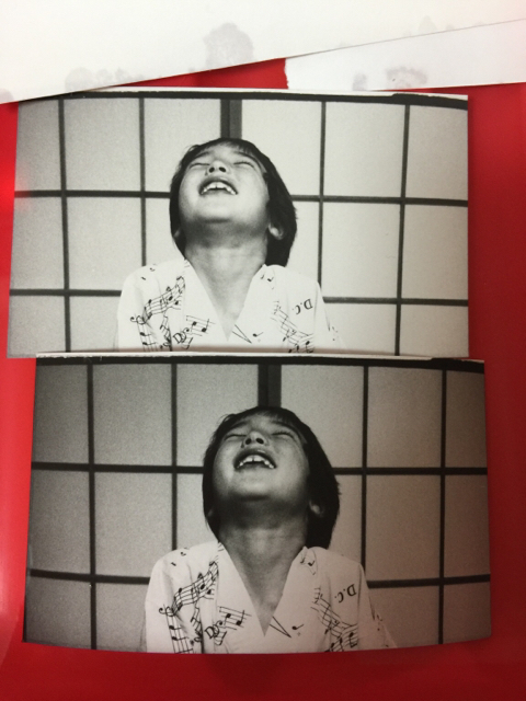

Hello all,
Here I go with my first test.
500ml of the earlier mentioned developer and the same photo with the same exposure etc developed twice.
1st: developer as it was (120sec)
2nd: like before +15ml of 2% BZAT (180sec)
The 2nd try started developing a lot slower - that's why I left it in longer.
It's also a lot less dark but I am afraid this could be from the killed developer?
Please chime in for this newbie. Thanks!
Ben
Confusing layout sorry. Top one with BZAT / bottom on with clean developer.
Wayne
Jul 8, 2005
3,622
USA
Looks right to me, but I'm no technical expert. The 2nd one is darker and developed quicker because the fog gave it more "exposure". That's my non-technical expert opinion. I think the first one looks good, much cleaner highlights.
