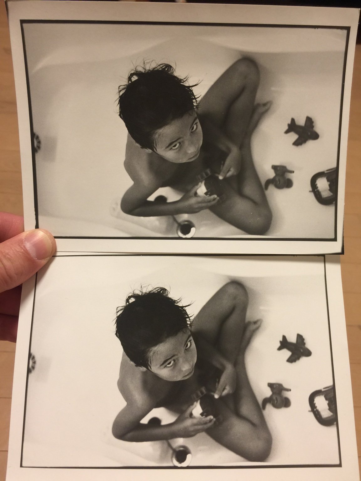

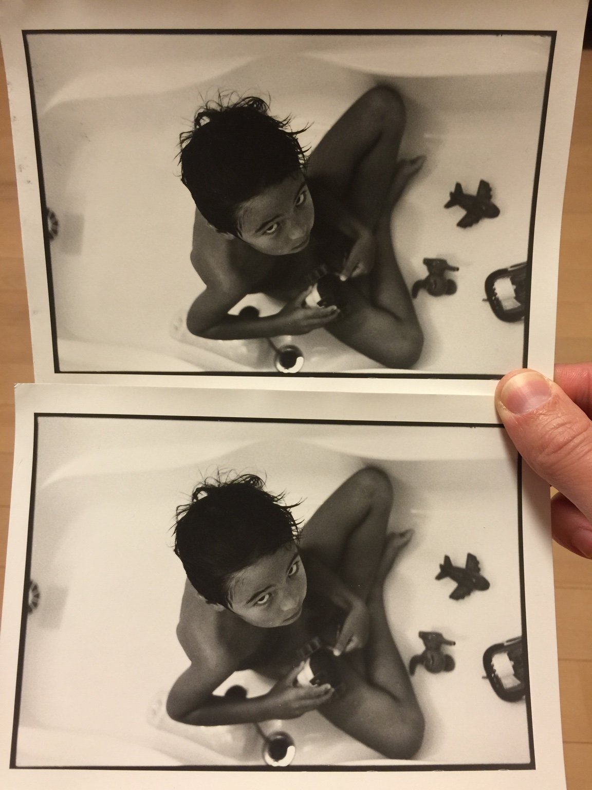

I have tested the BZAT solution I had originally trouble with yesterday and got some surprisingly good results.
The paper is Forte Bromofort BN-4 which was a normal grade paper (3). This pack is from the early 90's. I've printed the below shot in normal developer (top photo) and then with 30ml of 2% solution added per liter (bottom photo)
For the BZAT development I had to expose a little longer (7sec as opposed to 4sec) and developed for 2 minutes both. The BZAT paper started showing the image around the 1minute mark whereas the straight developer started at 20seconds.
You tell me what you think, I can see a contrast increase while the boy remains more or less the same on both image. The negative is very contrasty, pushed Eastman 5222 @400 in Rodinal 1:50 for 11minutes.
Thanks,
Ben
Edit:
I then tried two more in the same BZAT developer.
Same as the 2nd photo but developing for 3 minutes which I thought was a little dark so for the next try I reduced exposure but kept the 3 minutes developing.
Top: f16 7sec / 180sec
Bottom: f16 6.5sec / 180sec

Of course, the lower pics show cleaner whites. (But I have to laugh: in the USA this picture might get you arrested!!!) - David Lyga

That's my son - hope that makes it okay :smile:
So you think I am better of developing for 120sec or should go for 180 and expose less?

I am confused: the data you give says you developed both for 180 seconds. The real test is getting enough contrast. Even the top one could have been rectified with Farmer's Reducer as long as you had enough density to withstand the reduction.
Your paper is probably not that fogged, so you are flexible with what you do. But with VERY fogged paper (coin test reveals more than 50% density in unexposed area of coin) you are best advised to develop until that 50% is reached (in order to acquire as much contrast as is possible), and not beyond, because if you go much beyond that you will end up with a situation whereby the reduction will not leave anything left of the image: little differentiation as everything will be dark!!!) Structure your development so that it does not go BEYOND that 50% coin threshold. THAT determines how much you develop.
This is a bit strange to understand, perhaps, because with fresh paper you have no such threshold to worry about. But with age-fogged paper, you want as much contrast as you can get, so you want to develop as long as possible. But since contrast begins diminishing after you reach that 50% threshold, so you must hold back when that point has been reached.
Two more yen added to the tally. - David Lyga
Hi David,
I posted 2 photos each in the 2 submissions above - that's 4 sheets of paper.
From top to bottom:
1: Straight developer / f16 4sec / 120sec
2: BZAT added dev / f16 7sec / 120sec
3: BZAT added dev / f16 7sec / 180sec
4: BZAT added dev / f16 6.5sec / 180sec
You explained the coin test already in PM which I didn't fully understand so I keep reading it again and again.
