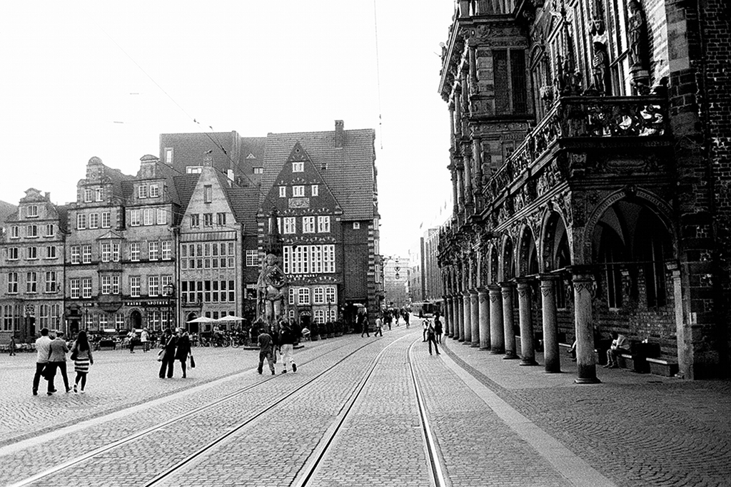

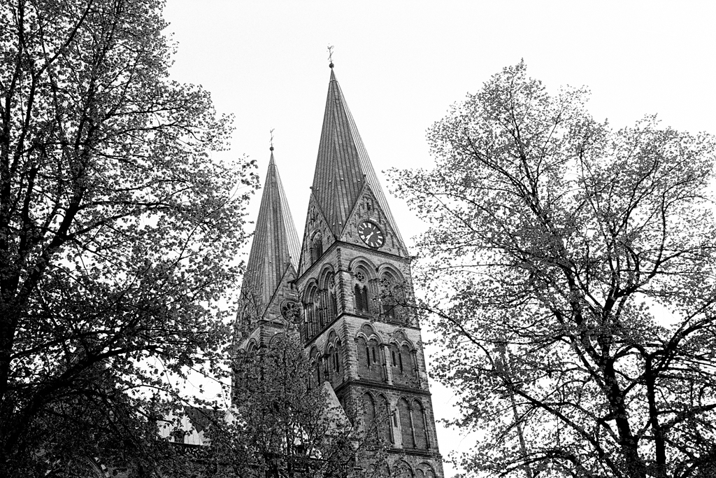

Pictures came blow-out. I do not know how to use centre-weight meter properly.
Camera: Olympus OM-1n
Lens: OM Zuiko f=35mm.

You're meter is probably seeing that bright sky and trying to set it to medium grey. Meters are dumb, that's the first lesson, and from there you can learn how to get the right exposure. If it is center weighted, it is averaging the scene towards the center of the frame. If there is a white car in the center, it will under expose (making the car 18% grey) if there is a black car, it will over-expose (making it %18 grey).
So, with this in mind, looking at your shots--turn your camera towards the buildings without the bright sky and take the meter reading. This will put the buildings in the medium range. Use that reading even though when you go to shoot the actual scene it will have sky. It will take some experimenting to get used to, but eventually you will learn to meter something that you want in the middle, then keep that exposure although you're meter is telling otherwise.

If these are representative of prints on your standard average paper grade (about grade 2), then you need to reduce your effective film speed and your development time. This is too contrasty, which means the negative was overdeveloped, and there is little to no shadow detail, which means it was underexposed. Try cutting the film speed you used in half and reducing your development time by about 20% for traditional films, or about 10% for T-grain, Delta, sigma, or whatever other designation the film maker gives their 'engineered' grain film.

Apart from huge amounts of overcast(?) sky, there's also an enormous contrast range in these shots, especially the first streetscape. What's a dumb centre-weighted meter to do? Meter off a midtone next time.

How does your negative look? Looking at your scan, it looks like some shadow details are there so that your camera's reading was probably affected by the bright overcast sky. That means it was under exposed a bit. If you metered correctly, meaning increase exposure a bit, the sky will be even more exposed.
If you had an overcast sky, there weren't much detail there to begin with.
You *could* have increased exposure a bit and get more shadow detail. You *could* have reduced development time to get the contrast range reduced. But, you still have a blown out sky with no details.
You might just have scenes that are impossible to "do it right."

I use a quick-and-dirty method with a center-weighted meter. I use grass or street pavement as a convenient mid-tone, then I hold the exposure and re-frame. This works very well for me.

There is also the blue sensitivity of the film - add a yellow filter to whack most of that out. I never shoot without one anymore - surprising how much it helps really.

I am going to disagree from most everyone here about your two examples.
It appears to me that the stonework is more or less properly exposed. If you do as may others suggest and meter off the ground or grass or gray area of the buildings, the sky will still be blown out.
If your camera's meter was off due to the sky, the sky would be closer to a grey tone and the foreground would be way way darker.
I think I have a similar shot here:
I think instead you just need to control the contrast by either using a yellow or orange filter or developing for less contrast. I would probably try the yellow filter first.

Given the examples, I don't think that exposure is actually the issue.
I say this because the main subject matter actually looks nice and the sky in the scene was described by baachitraka as pretty clear.
baachitraka I'm going to guess that you expected a darker sky, not more detail.
I'd also bet that if color film had been used here the sky would be a nice blue not the blank white area it shows here.
If my assumptions are right using a say a red filter to get a darker sky might actually be the fix.

The response of B&W film is not more sensitive, but it is distinctly different than color work. It requires some experience and for you to think, work, and see differently.
Without color; composition, subject choice, and texture become much more important.
Without color you also have new tools to manipulate the scene. For example in a color shot of that same scene the sky may still have been too light.
With B&W you can use say a deep red filter to skew the amount of color the film can see. In this case you are not letting the film see as much blue and since the sky is blue the film doesn't get as much exposure in the sky areas.
