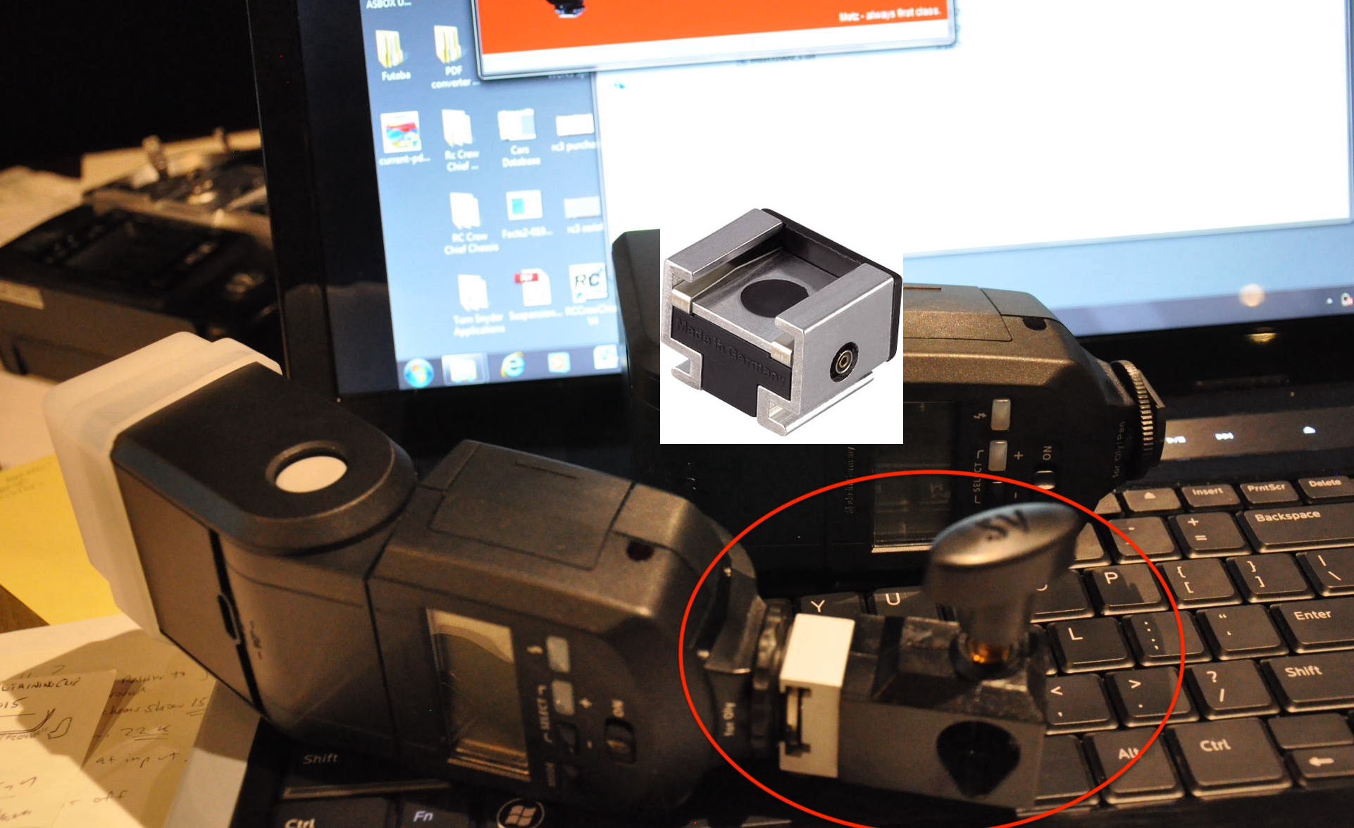

Mount the flash on a light stand with an adapter like shown below with a long PC cord. Remove the cable from the flash to the camera and connect it to the Sekonic 308.
Follow the instructions for the 308 to make the reading. Re-connect to cable to the camera.
