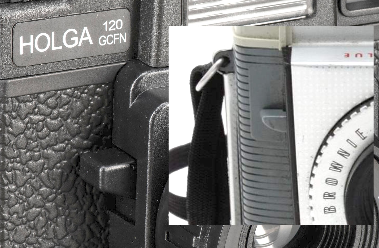

I have several cameras with awkward switch/lever style shutter releases and no cable release socket. Maybe the most obvious example is the Holga 120, but the Kodak Brownie Starmeter is another. Something has been tickling my mind for a while, wondering if I can repurpose some commonly available object to create a plunger-style release that would be reachable atop the camera where I find it more convenient, as well as accepting a cable. (I know there was an accessory for the Holga, and you can still buy 3d-printed clones, but I'm trying to think of something less cumbersome and which I could apply to other cameras too.) Photo of the Holga with an inset of the Brownie Starmeter, in case folks aren't familiar:
