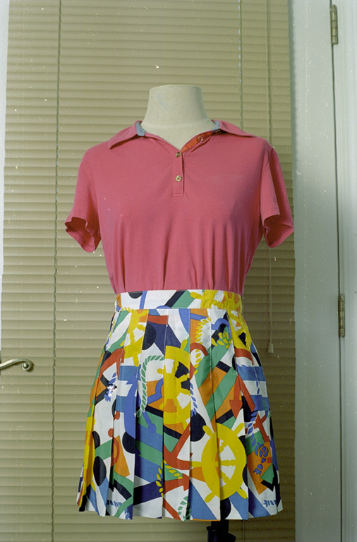

Here is an image out of my scanner without any adjustment done to the scanner. Basically all the adjustment, if there is any, is not by me. The image actually does not look great. Colors are somewhat muted (the NC look?). Very flat with no dynamics. The histogram does show everything falls between 0 and 255 (RGB density). The colors may not be accurate. There is no skin tone for evaluation so I am not concerned about the accuracy of the colors.

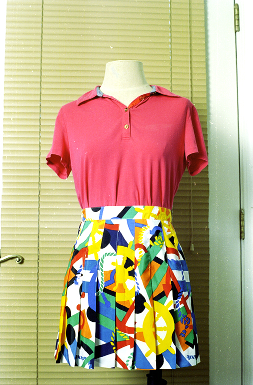

I did a quick post processing to the initial scanner output. The adjustment I did were simple level (contrast and mid tome) tweak only. Here is the image after the adjustment. It looks much pleasing now. But it is not the look of Kodak NC any more. It's more like Kodak UC. It's a manual post tweaking, not by the scanner. But despite the picture looks much pleasing now it does not mean much in terms of if the film was processed correctly. The question remains if the scanner and my post processing actually masked off the errors. Can anyone share his/her thoughts if I can judge by looking at this final image if my processing is good and no need of any concern. Or I should consider the picture good enough as Koraks suggested. I do feel good about the final result.
This is probably too much.
