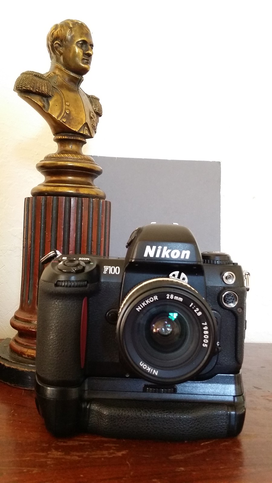

Oh, So, I find the scene I want to photograph, meter regularly, then place the gray card in that scene area, then adjust -+ exposure, correct? I think I get it! :whistling::D Napoleon, and my Nikon F100, and I, thank you! Especially for such a novice question!
20141029_135226 by a.rodriguezpix, on Flickr
If you are looking to use the grey card to determine exposure, you would place it in the scene in the same light as your subject then take a meter reading of the card only by getting close enough that the card fills the frame.
If you are using as an aid for determining color balance for a print, then you place the card in the scene and photograph the card and the subject, similar to what you've posted. I usually shoot one or two frames that include the card per lighting set-up then exposures of the scene without the card for the actual prints.
The F100 has a spot meter so you can just meter off the gray card with that so long as it is big enough to cover the spot. No need to fill the whole frame.
If you have a white piece of paper with something black in the middle, you can figure out pretty quickly where the boundaries of your spot meter fall in the finder. Mine is pretty close to the brackets of the center AF zone, maybe a little bigger.
