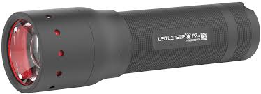

Could be "lightpainted" with tungsten type flashlight (or maybe a gelled one" zoomed in tight.
Also could be done with a couple of gelled, zoomed and gridded speedlights, snoots as mentioned could also have been used. DIY Grids can be made of straws.
I wouldn't overexpose since the more overexposed the more white the result.
These are pretty powerfull but gels are needed
