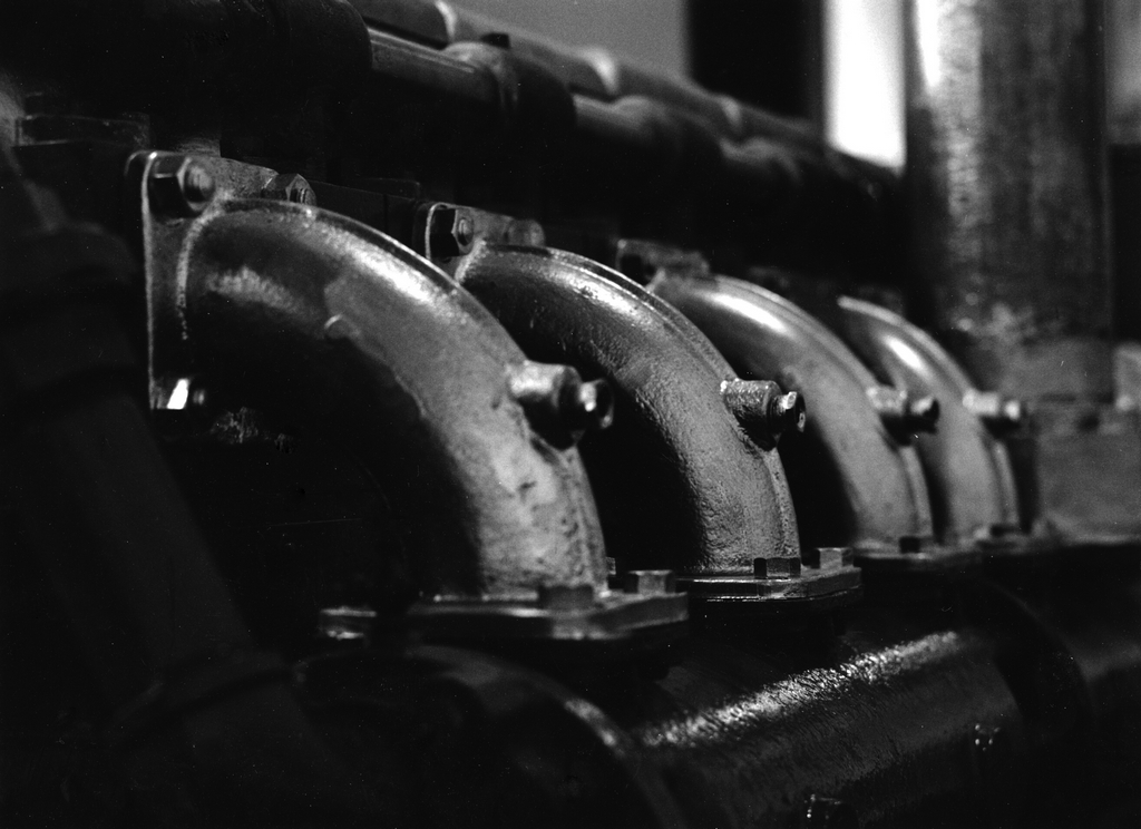

Or is this one what you were thinking of:

@MattKing , what an awesome print!!! Is this from 35mm film? If so, which film, ISO, film developer, paper, paper developer did you use? Once again, awesome print. I'll consider myself goal achieved the day I am able to make this kind of prints ...
Thanks.
Sometimes I can answer those sorts of questions, and sometimes I can't.
In this case, it is 35mm T-Max 400 (TMY-2). Exposed I think (but I'm not sure) in a Retina IIIc with the 50mm f/2 Xenon lens.
Developed in HC-110 dil E.
I have both a work print and the 9 year old scan I shared. I'm not sure, but I think that the scan was from the negative, rather than the print - I go back and forth between those two ways to digitize - but the view on the screen does emulate the print. That print is on my usual RC paper, pearl surface in this case. At that time, it was either Ilford MGIV RC or Oriental RC.
I didn't pick that particular image for any other reason than I thought it resembled a little bit the examples you referred to.
