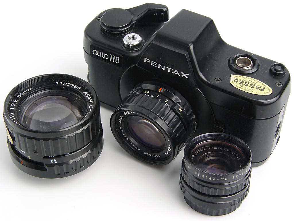

Depending on your budget you can buy a 1/2 frame camera or use 110, some sell repackaged 110. Pentax made a 100 body with interchangeable lens, Minolta a zoom.
