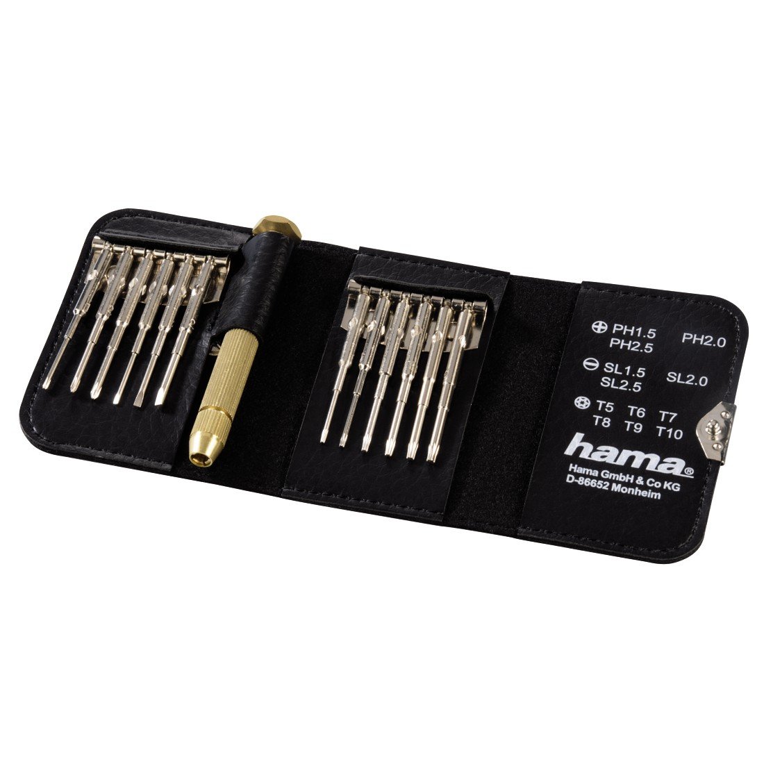

That set above likely is made in Asia.
It is a interesting kit, using key-holding bars to attach screwdrivers to.
It can't be that old as it already contains Torx drivers.
