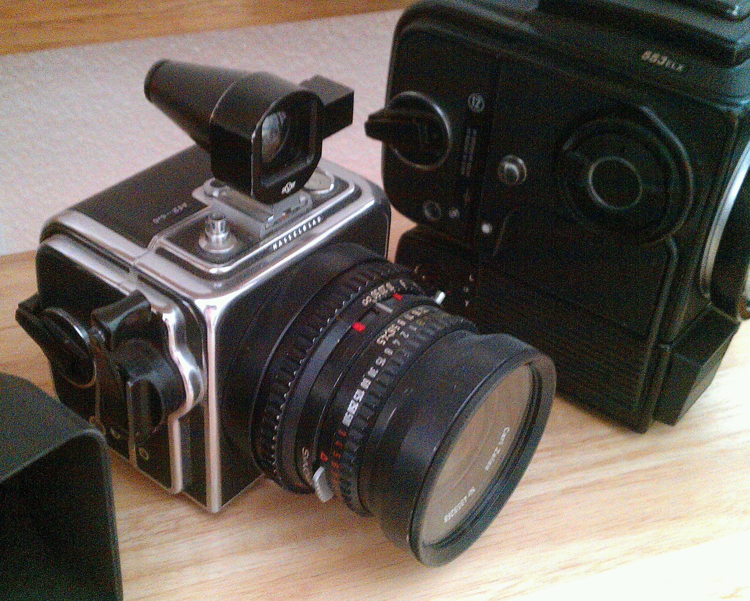

Use the SWC Biogon and be done with it!

Having the landscape sharp from the tripod legs out to the mountains is part of what I think the Group f/64 movement was about, but I've always thought it strange because human vision doesn't see an entire landscape, front to back, as in focus all at once - instead, we focus on individual parts of a scene. I suppose that could be used as an argument for having an expansive depth of field in the image, but I think few images really benefit from such extreme depth of field. Just my opinion.
Yes. This is what we all do eventually.
