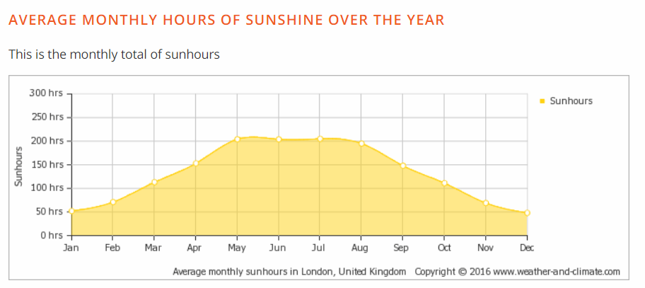

Wow...
that's not much sunshine during the winter. But still, if you stuck a solargraphy can out for 2 months, it might get 100 hours of sun, on different days, and they can look even more interesting if it's not sunny every day. A bigger challenge is keeping condensation out of it, and I haven't solved that yet. It's no fun going to collect your can and finding it full of water up to the pinhole. I've made a couple with a "drain hole" stuffed with black foam ( hoping it will keep the light and bugs out, but let the water seep through... ) but haven't tried them yet so don't know if it's a good idea or not.....

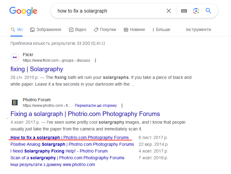

Can you show the Google search you used, please?
It's possible Google doesn't index our Resources.
of course,
mine looks like this, underlined one is this topic
