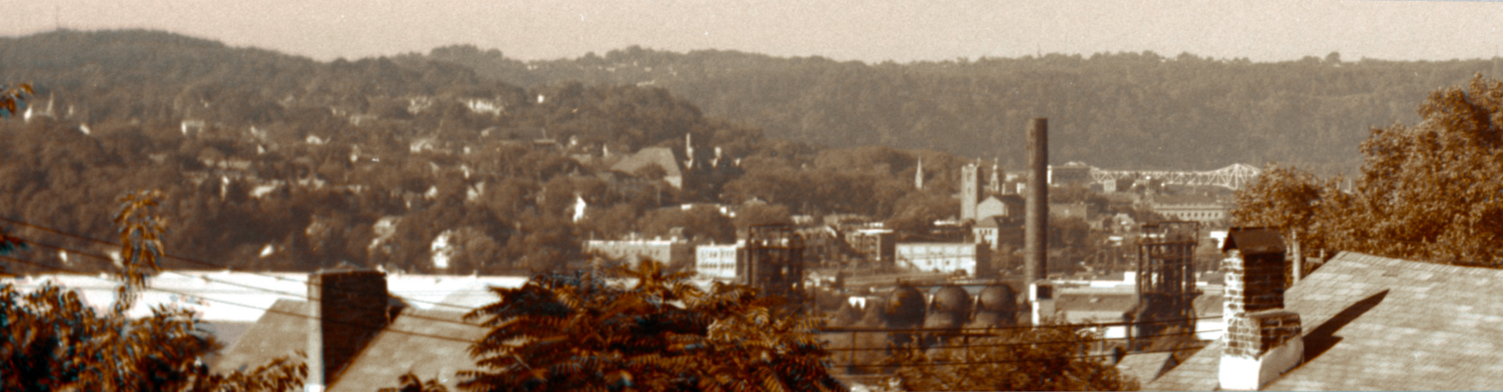

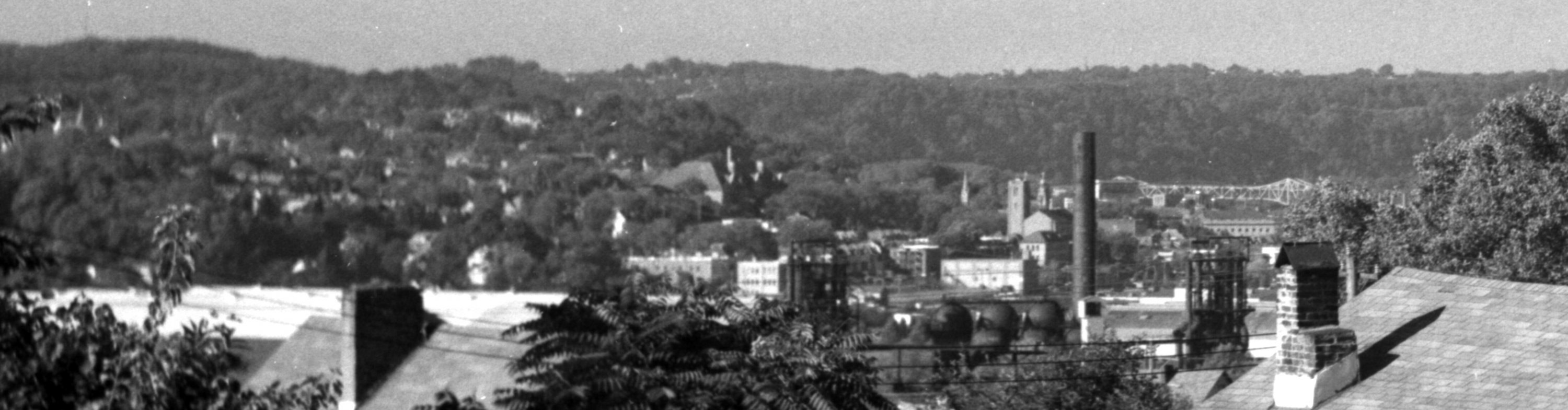

The top one was shot straight f16 1/100 tripod. The same with the bottom one only with an orange filter added f8 1/100 tripod. This is a very great enlargement from 120 Arista 100 film processed in D-76 9 min. The orange filter lightened the trees close by, darkened the sky, and lets you see trees in the farthest distance. There is a hill above the bridge that cannot be seen in the top one. However, depth suffers in receding planes of dark to light gray as the no filter photo looks better in that regard. The orange did cut through the haze though.
The orange filter did boost contrast a bit, comparing the bottom photo to the top. Have you try using the red filter? It may give you what you want.
Seems like a waste of time using B&W. The whole point of photographing the fall color is the color! There is a basic problem. Green and the set {yellow, orange and red} are complimentary colors. Use a green filter and the warmer colors are darkened. Use a Y, O, or R filter and the greens are darkened. The overall effect is pretty much the same some leaves dark some light. Once all the leaves turn they become warm colors and a yellow, orange or red filter is not going to get you anywhere.
I took the two images, and tinted the orange filter one orange in photoshop and merged it with a slightly bluish version of the unfiltered image and manually lined them up. You can see the orange filter clearly has an effect and the toning is intriguing. Care would have to be taken with registration at all steps. I don't know if the background trees had a mix of green and orange leaves yet.
I'm not sure how you'd make a final print. Perhaps digitally as in this experiment. Perhaps make an orange toned print and lay over a cyanish transparency. Getting registration and levels right would be fussy.

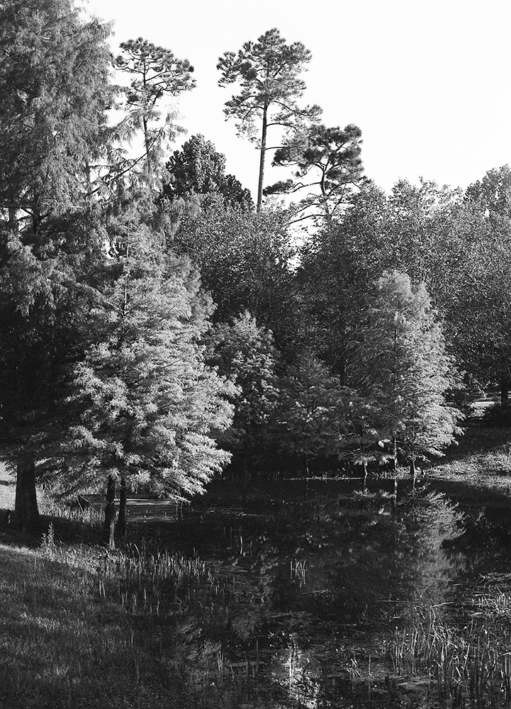

The only fall color around here this time of year is cypress, bonus that it grows near water. I'm not a fan of that composition, or maybe it's the time of day. This is Arista Edu ultra 400. Pentax 645 80-160mm(probably at 80mm and somewhere between f8 & f16) . Processed in D-76 for 13 minutes 70ish F. I may go back tomorrow with some HP5 and a red filter. I hate the boring sky. This was in the morning about a month ago.

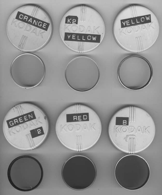

Another version of this had been uploaded but it went away. The orange filter works for me with one to one and a half stops more light. I've used the red filter with +3 stops and is worked differently with try-x and with HP5. Better with the X. So it will depend on the film and processing what happens.

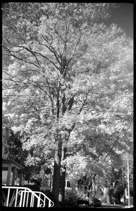

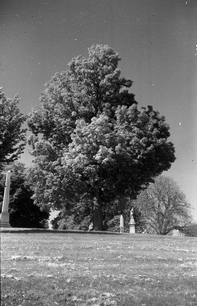

The picture of the tree was f11 orange filter 1/100 Arista 100 in d76 9 min 1:1
The center of the tree was bright orange. The rest of it was green.
...The orange filter works for me with one to one and a half stops more light. I've used the red filter with +3 stops and is worked differently with try-x and with HP5. Better with the X. So it will depend on the film and processing what happens.
Beautiful collection! For me (that) orange is (1 & 1/3) more or less the same, and of course it (does) depends on the film. Thanks for sharing that tree example. It seems that the sky is full of "stars" ...
Is that a scan of a print and is the lighter part of the tree the area that was orange? If so the orange filter appears to have worked quite well
