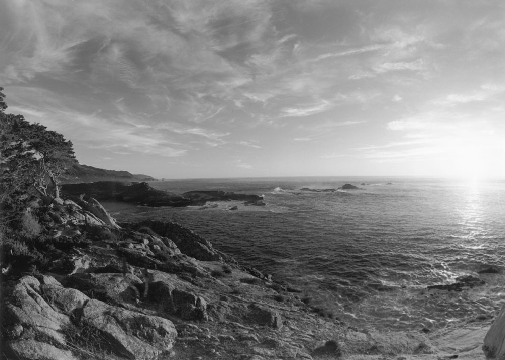

Just the sun and the horizon aren't terribly interesting. I suggest including a lot of the shore line, exposing for the sea and shore and letting the sun do what it will. I can't see a filter helping a lot, maybe try a shot or two with a 25A red if you have the belly of the clouds lit up by a below-the-horizon sun.
An example from Point Lobos, California. Technical Pan, no filter, 16mm Nikon fish-eye. Sorry, it's a crappy scan of an RC work print - not anybody's idea of optimum.

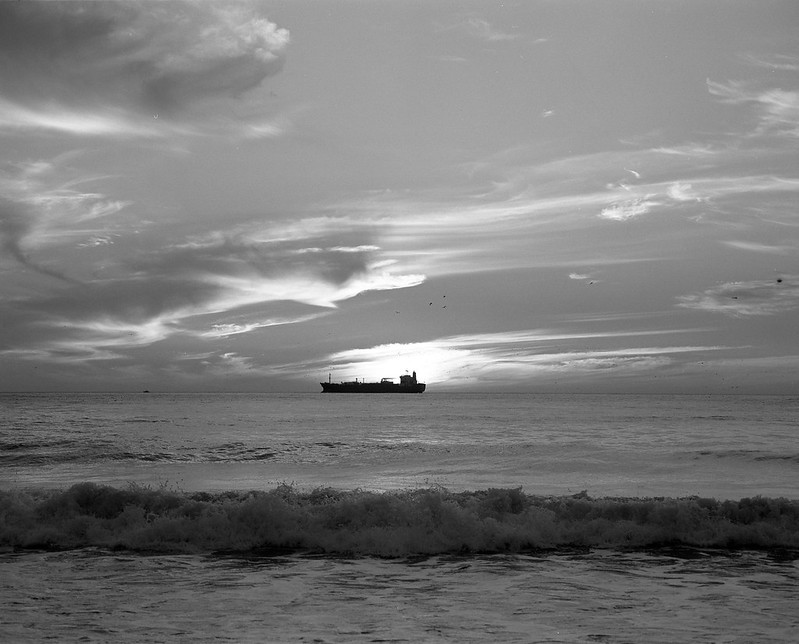

I don't think it makes all that much difference what film speed you're shooting at; if you are using TMAX3200 at 1600ISO, then simply meter for that. But it really depends on your subject, I think.
I haven't taken too many shots of beach sunsets, and the only one I could find I was intending for the a ship close to the horizon to be silhouetted, so I just took an incident light metering from where I was standing. Shot turned out ok, and I did get the silhouette.
Sunset
by D.R. DuFault, on Flickr
Vina del Mar, Chile. Mamiya 7ii, Kodak TMY-2, XTOL 1:1.

That look very nice.:cool:
Where was the dome of your meter pointing for that shot.?
IIRC, I just held the meter vertically, with the dome facing the direction of the shot, towards the horizon.
