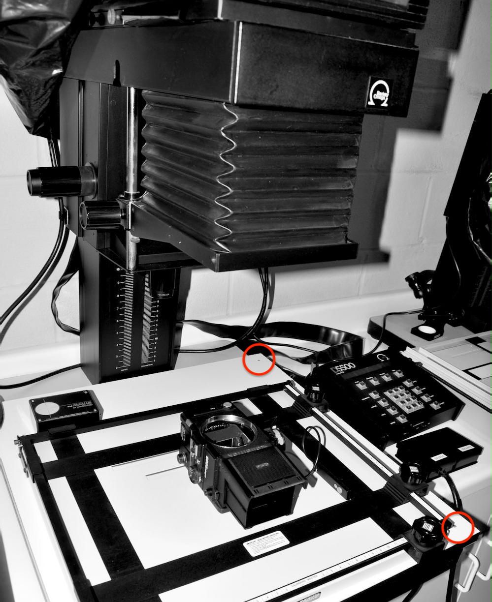

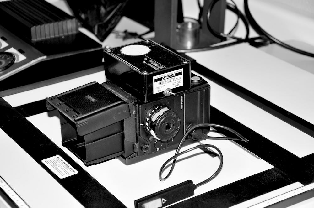

I use my enlarger to project the image directly onto film.
My fancy "film holder" is actually a Rollie 6008i body which, conveniently, contains a TTL meter that lets me know the exposure time.
I have done it two ways that both work:
A) Set the camera to B and use the enlarger's timer
B) Use the camera's mirror as a makeshift shutter with the cameras timer (only good for exposures greater than 1 second).
