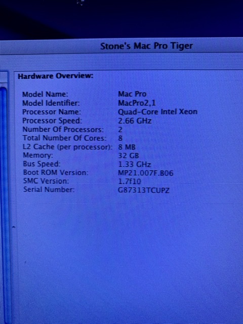

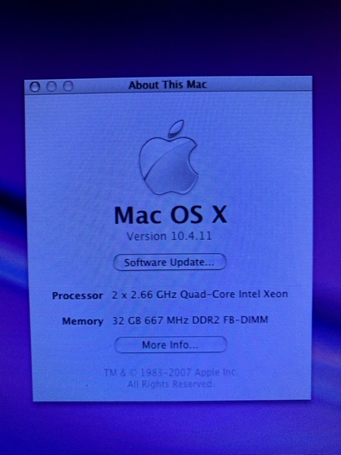

Stone, what is the spec of your Mac Pro? - btw, you may be able to find a reasonably up-to-date browser that works on your machine if you search.
I suspect the difference is more extensive with more difficult scans, poor exposure, contrasted lighting, long exposure with color shifts, where I need to make a lot more adjustments, the ability to drag the specs for darks and lights and everything on the histogram is just a lot more extensive in function.
I did check, I junked them all and had formatted the hard drive a few times attempting to install on the Mac mini I had.
The machine I now have is a lot faster anyway, so I think it’s probably better that I did this regardless.
Do you need more specs than this? (2 PicS below)

Your Mac Pro looks like a very good option for running a scanner. You could always install another more recent operating system on an additional hard drive if you neeeded to at some point. A quick tip, you can do a partial screenshot on Mac OS X with the keyboard shortcut 'command-shift-4' and then drag out the area to be included with the mouse pointer.
