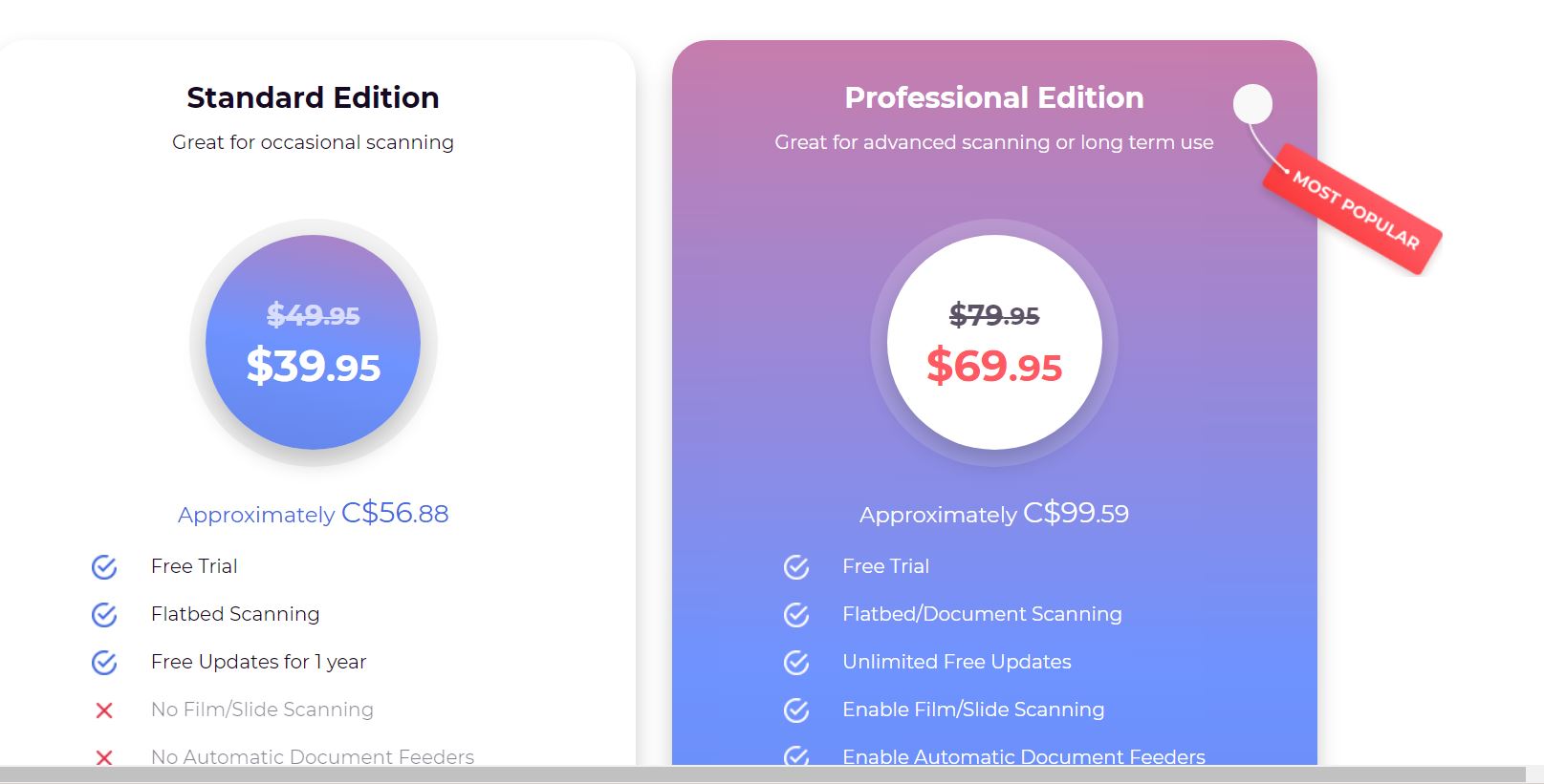

Vuescan is $69.95 USD for a single license.
A 10 user license is $400.00 USD

Scratch that. It's 99.95 at the moment.
Don't know what the OP's time is worth but $99 is a bargain compared to the labor he's about to donate to the cause. If using a spare old computer and "sticking it to the man" is part of the fun, well I get that. But in this case "the man" is a very small company indeed, and one that offers free unlimited updates to keep your scanner working with modern computers. Something to consider.
Fascinating - this is what I get when I click on the "Purchase" tab at hamrick.com:
