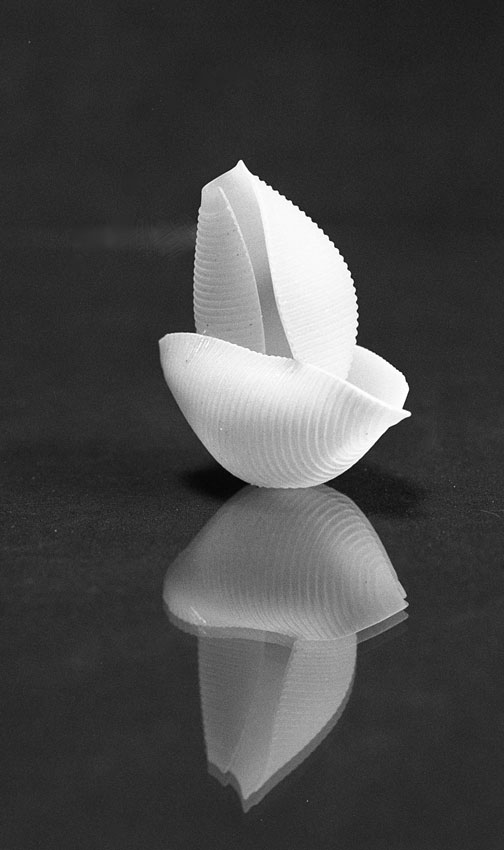

If the shot is taken against a "black background" will the negative look thin in the black area? As in this example...
Hey, you're getting there! Looks good. I like the idea of mirroring the curves. I also like the tight shadow. I am not so wild about the doubling effect in the reflection but you can fix it. Keep it up, it's getting there! Rememebr that quote from E. Weston, who worked very hard to balance his shells...something like: woe unto anyone who disturbs my shells before I take the photograph :wink:
Regarding tones, it's hard to judge on my (uncalibrated) screen, but I think they can be improved when you print.
Keith, you know I am copying you with this shot! the double reflection I think is the camera is seeing both side of the clear glass????
My question is will the negative in the dark shadow area be thin???? I hope you say yes.....
Yes it will. You don't want it to be completely blank of course, but it will definitely be much thinner than the highlight areas.
You might be able to kill the second reflection by putting a layer of water between the glass and the table. Maybe. There are magic angles....
Well, that is not black, but dark gray, so it should be "fairly" thin - nearly clear - but still a little density and a little detail.
One caution ...
When we talk about target densities (thin or thick) we want to be paying attention to those parts of the subject that have important detail in them.
If we want something to be displayed as an un-detailed black shadow, we don't care if there is no detail there, so whether or not that section of the negative is 1, 2 or 10 stops underexposed doesn't matter.
If we want something to be displayed as an un-detailed bright highlight (like a specular reflection), we don't care if there is no detail there, so whether or not that section of the negative is 1, 2 or 10 stops overdeveloped doesn't matter.
For your example, it looks to me that you would most likely want detail everywhere, so this issue may not come up. For something else, it could be quite important.
