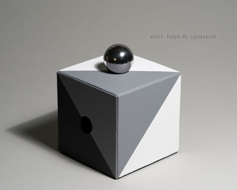

Weak rebate numbers may be a sign, but they don't have to be. A proper film test will tell all, but without changing your development scheme, check the following:
1. Put a scene together from deep black to bright white (black felt, gray card, white cloth).
2. Evenly illuminate it, measure it with an incident meter (or on the gray card) and take a picture of it.
3. Develop normally, expose the paper for the shadows to be right while printing on a grade-2 paper.
Skip step 1 & 2 if your negatives already picture such a scene. Now, ask yourself, are the highlights gray (underdeveloped film), too bright (overdeveloped film) or just right?
By the way, I made myself a Zone Cube to simulate such a 'perfect' scene (picture attached).

Ralph,
What a cool idea......the zone cube.

That's a clever idea Ralph....one might easily use the "cube" to test exposure and development relatively quickly when contemplating the use of a "new" film. Do you have the design of the Zone Cube in your new book?
Ed
The idea is not new and it is not mine, but this implementation (Zone Cube) is, and it works well for the purpose you suggest. It did not fit into the current edition of Way Beyond Monochrome. Maybe next time :wink:.
great advice !
btw
the zone cube is one of the coolest things i have seen ...

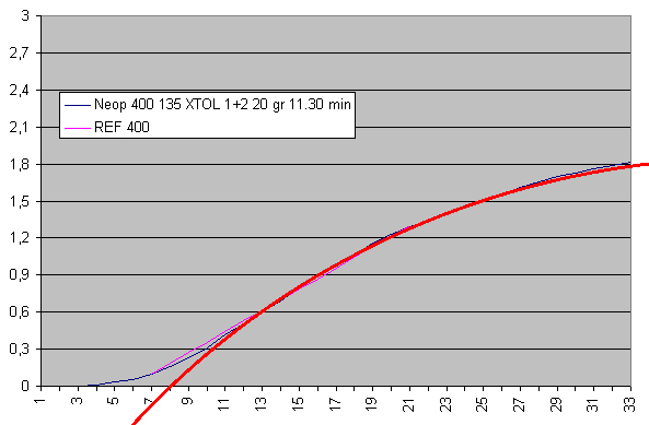

Without seeing your image, it is impossible to judge what is going wrong. Based on published curves, and my own experience with Xtol and Neopan 400, you can do everything right and still get gray negs. The shoulder at 1.2 or so means that if you have over exposed the film by a small amount you've pushed the highlights into a part of the negative that is trying desperately to compress what you want to expand.
Neopan and Xtol. Barry, it's kind like trying to build a fiddle out of cardboard instead of maple.

I like that cube, Ralph. Is that an original idea? If so... pretty brilliant!!
Thanks. Unfortunately, not my idea, but a cost-effective home-made version with some improvements added to the commercial versions out there. The Spyder Cube by Datacolor was mentioned, but it is very small. By the way, that was not the original idea either. These things have been around for some time. A photographic professor in New York presented one decades ago.
I was ask to post something about it and will do so soon.

... if development is significantly off, an experienced eye using a good loupe should be able to note the problem. Matt
I used to think I could do that. I can't. Only printing can determine whether there was correct development.
The problem is the small difference between being right on, and being a little bit off. The problem is compounded using a film & developer that make a strong shoulder. The Foto Import curve below shows Neopan 400 and 1+2 Xtol, with agitation every 30 seconds. It is very similar to the 1+1 curve, and is consistent with my own results.
I drew the red line over the curve. It is an arc. It shows that Neopan in Xtol is nearly ALL SHOULDER. Beginning at Zone IV, it takes progressively more exposure to raise the Neopan image density. In other words, the higher up the scale, the LOWER the contrast. It takes 2 stops of exposure to get from Zone II to Zone IV. To raise Zone VII to IX, it takes 3 stops. It takes 4 stops of exposure to go from Zone VIII to X.
If this is the case, there is no way to assess the problem without knowing the characteristic of Neopan and Xtol.
