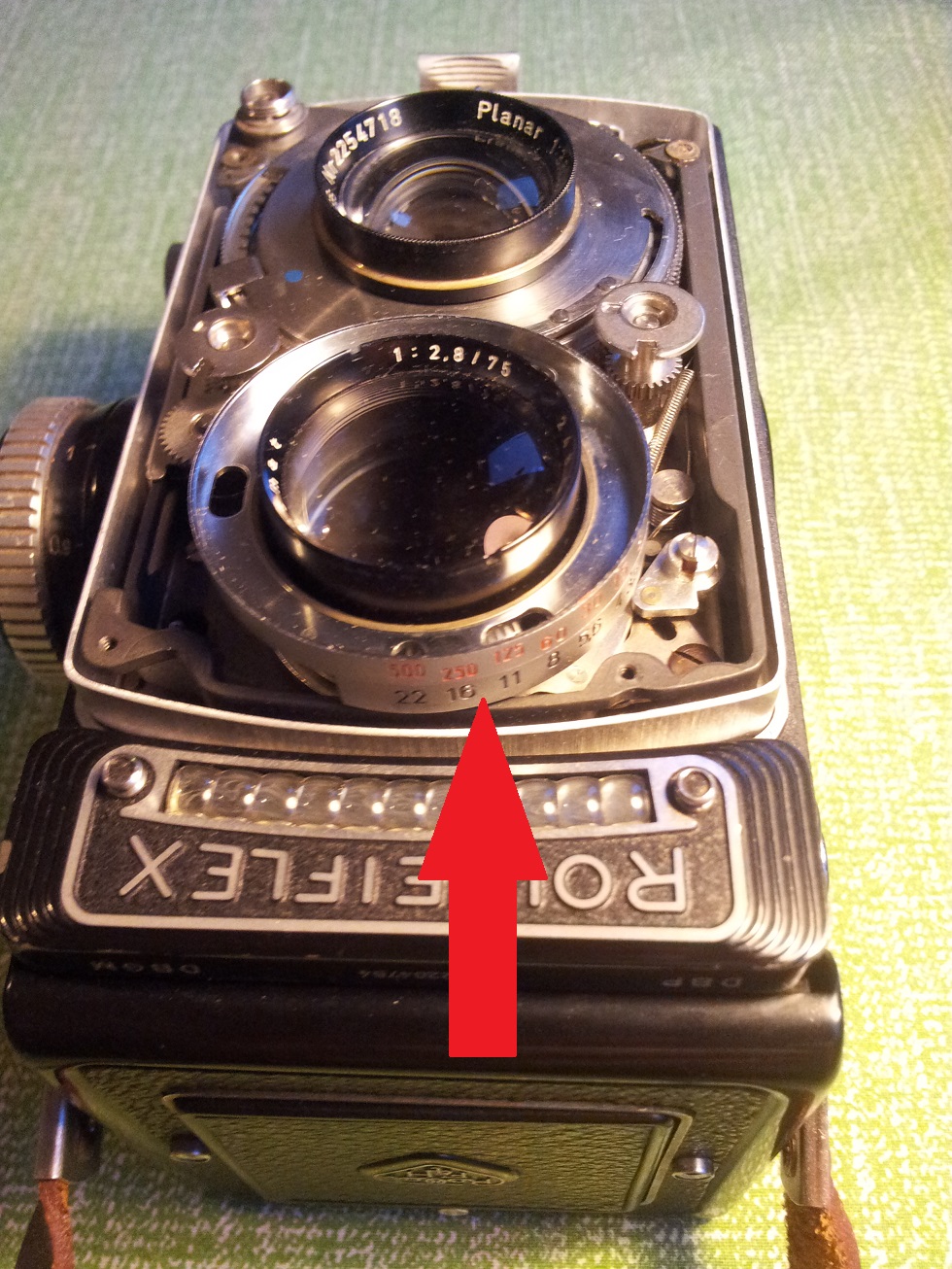

does anybody know how to disassembly the shutter speed drum and aperture drum around the sucher lens:smile:
thanks so much for help

The 'cross-coupled' manual and the Rolleiflex F manual, both for National Camera, would probably be of use. The major issue with the F model is getting the coupling mechanism back in proper alignment.
The shutter/aperture rings in your photo are not like the older models, so I can't offer any advice on getting them off. I have disassembled the older mechanisms, and one thing you must do is study the alignment of the rings in relation to the dials that cause them to move. The F with its meter coupling will make this an area to study for a long time, and take apart very slowly. The rings will need to be returned in alignment with the meter coupling.
It's your camera to do with as you will, of course. Personally I figure my first run at any complex camera is going to be more of a dissection and autopsy. If I am not prepared to lose the camera, to end up with a parts camera, then I don't go in. I've overhauled a few Rolleiflexes for people. But I won't touch someone else's F until I have one of my own and do my learning on it.
Despite everyone's dire words, Rolleiflexes are well-designed, well-thought out mechanisms. Meaning that with some study and attention to various interlocks, they are meant to be taken apart and put back together. If you are experienced with such mechanisms and are patient, you can figure it out. Maybe. If I was doing this, I would probably establish certain base points, then remove single parts, re-install the part and check function, remove that part and the next one, re-assemble and check, remove one, two and three parts... etc. etc.

thanks a lot, that so many people have gave me advise for not trying DIY. I know rollei is a precise maschine. i am a conservative person and won't do anything disassembling until i understand the principle. every step i do, i will mark the position and take a photo of it. so if anything goes wrong, i can still through the photo or mark restore it. the camera metering system works well, so i don't need any alignment. what i need is only disassembly and re assembly in the same position. the shutter in slow speed under 1/15 is too slow. if i get the both drums off, then i can take the cover of shutter off and reach the hemmwerk (gear set in english?) i will put some watch oil in the hemmwerk.

i got finally disassembled, after little study the manual. it was quite easy. the viewing lens must be first unscrewed. by unscrewing you should remember how many round it was turned, so that the focus length not changed at reassembling. then unscrew the brass retainring (yellow) out. the best way to keep alignment is setting the aperture to 22 and speed to 1/500, so that the both drum keep in the end position.
to reach the shutter you should unscrew a very thiniy screw under photo lens and then remove the black retainring with remember the original position. it determine the degree of tightness of the aperture and speed dials. finally becarefull take the shutter cover and two gearring away and mark the position. after oil the gear set in the shutter. the slow speed under 1/15 run perfect

Suggestion: wait a few days before reassembling everything. Synchro-Compurs can be fickle. I've had them stop working after a couple of days of doing well. I've also had them go for three years after a couple of drops of naphtha and a couple of drops of oil. Go figure. All in all, I've had good results with the slow speed dragging with simple oiling like you have done.
Yes, I've done CLA of the 2.8F and 3.5F. It is a mechanism that requires great care to assemble correctly. Too much lubricant or the incorrect type, and the movement is stiff. And if you bend one of the rings, you could be in for a world of frustration.
And getting the meter and depth of field coupling correct is also tricky. And the malfunctioning part might not be where you think it is. That "bent metal clip" that couples the differential is most mysterious.
good luck if you got it all right.
