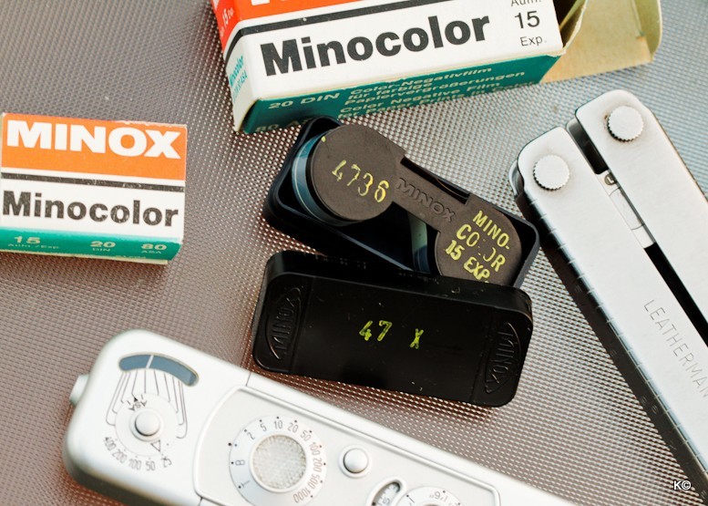

I couldn't find anything about this film in terms of developing. It is shown in attached picture.
attachment.php
My first film in Minox B camera I acquired yesterday. I have Minox developing tank as well, but I don't know if C-41 will works for this film.

Well, I was puzzled a bit by that 20DIN. There were not that much of that kind.
Out of those I think most likely the film to be Agfacolor CNS. Thus needing the obsolete Agfacolor process.

I was using East German Agfa slides film as my first film in eighties. :smile:
It is ASA 80. I set camera to 50. Could I get it developed as BW instead?

Well, this 15 frames cassette is done and gone. I used it to learn couple of hours ago for how to operate Minox developing tank. I have three Minocolor 100 36 left. Expired in 89.
Those are C-41 for sure. :smile:

Since you seem to have the box for these film cartridges, it's got to state the correct development process somewhere on them. 20 DIN is not a process, but a speed rating close to ISO 80.

Box saying for paper color prints. Color negative.
I'll check on three "newer" boxes.
Based on date and what I know now, it is C-41. It was only this particular cassette I wasn't sure.
Not necessarily. Especially with rare conversions. In the past some retailers (deliberately) used uncommon films for their brands to get a second profit from their processing service.

To the best of my knowledge, Agfa CNS films were 20 Din or 80 ASA. When Agfa changed to C41 process films the film speed changed to 21 Din or 100 ASA.
So since it's 20 Din film speed that that would suggest to me that it is CNS process, which is an obsolete process and not commercially available. However I have heard of some people processing it in C41 BUT at 20C (dev for 20 mins instead of 3m15sec) and not the standard C41 38C (it will melt the emulsion).
It could also be developed as a B&W.
If you search Agfa CNS you should get results.

I tried it as bw. It came out black. Google didn't returned much for this Agfa CNS thing. It was just one cassette, anyway.
