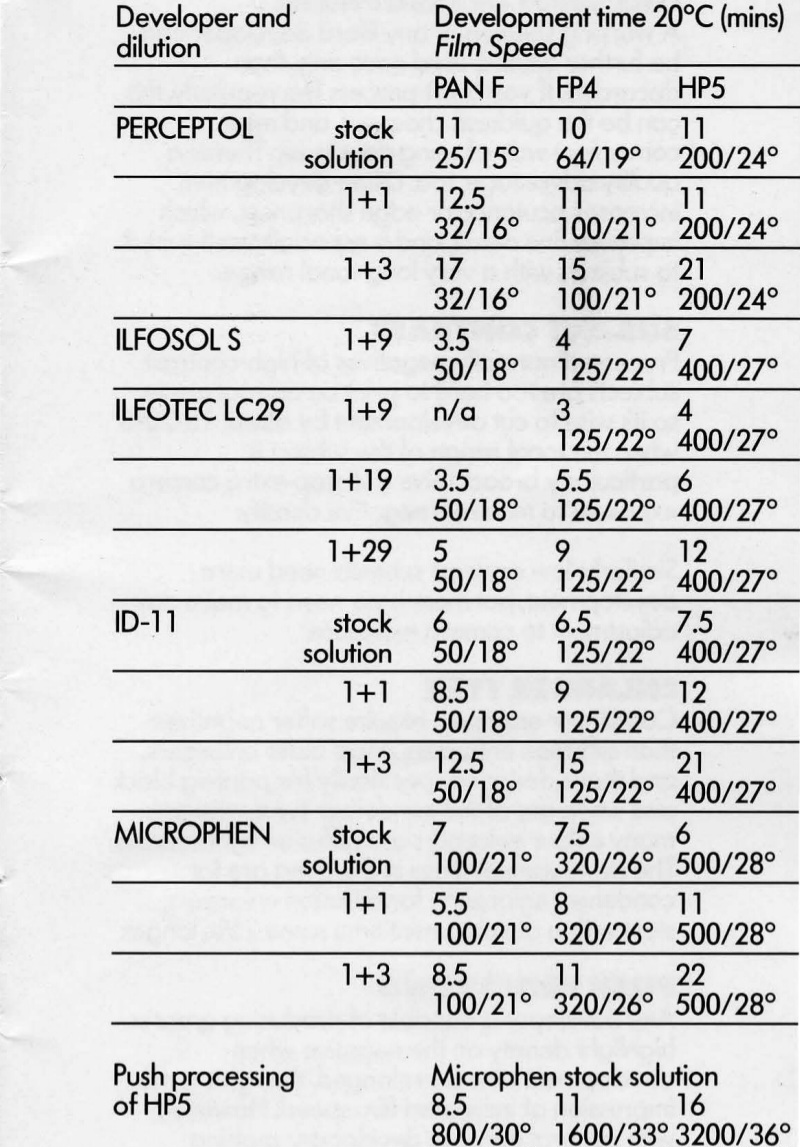

If you have the cardboard box, the developing times should also be printed inside.
