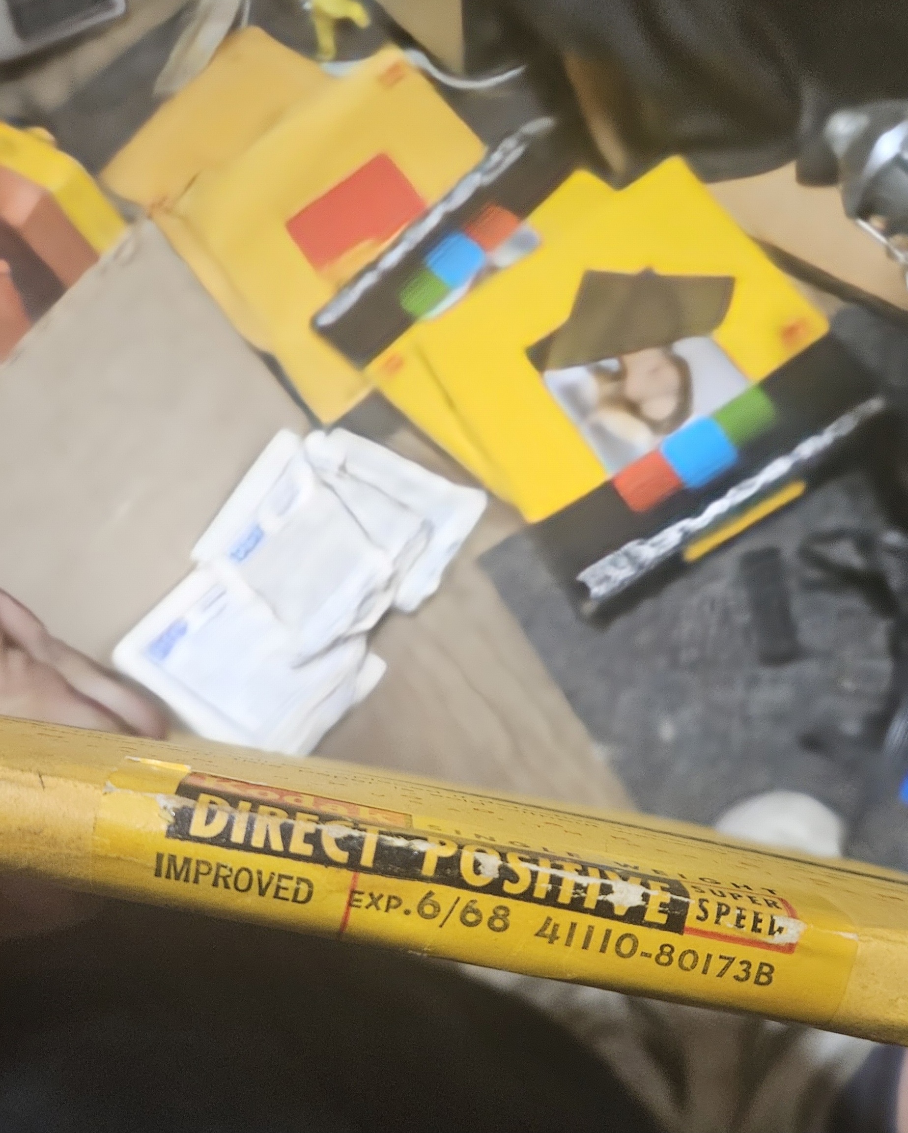

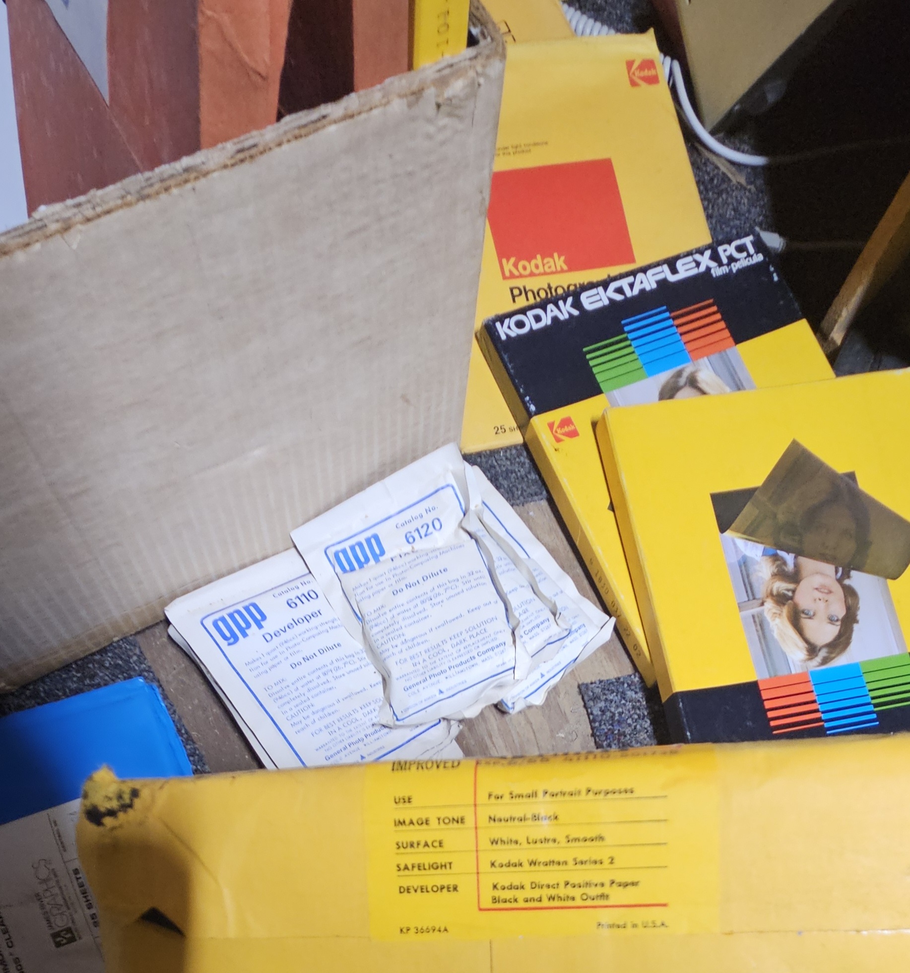

Sorry to open this old can of.worms but I can't find anything else mentioning this stuff. I have this sealed don't know what it's worth.
Welcome to Photrio.
Sorry to be the bearer of bad news, but that mixture of stuff is unlikely to have much, if any monetary value. Most of it is likely to be degraded past usability, even if the process was still in common use. And I doubt you will find any collectors interested in it.
It would most likely have been used either in an environment that required quick prints - e.g. a newspaper - or a print shop that used techniques and equipment that have fallen out of use.
