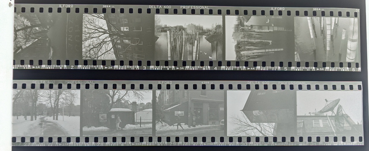

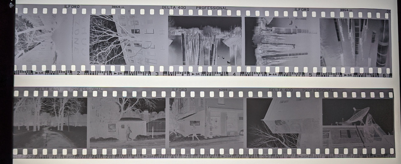

Here an example, Delta 400, phone picture on ipad 'light table', top a reference developed 1 year ago, bottom strip fogged developed a few days ago:

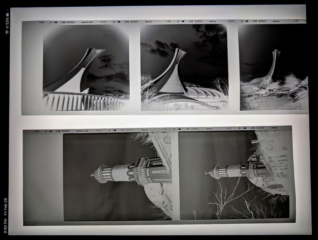

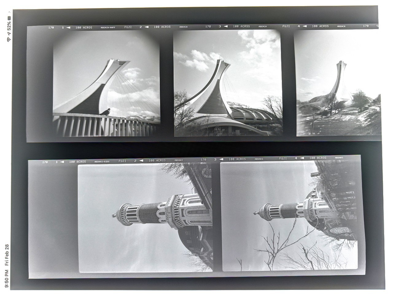

Another example, Fujifilm Acros 120, top reference developed last November, bottom fogged developed yesterday:
simple invert:
These are just quick scans to show the difference, the scans can easily be improved. The fogging is more obvious by eye, bu t I hope it's visible. I'm planning to do some enlarger test prints to see how it looks, and if I have enough contrast filter left to improve the contrast of the fogged images.
Pretty sure both Acros rolls came from the same batch, one big order last year before it was discontinued and haven't traveled except via mail to me. Delta 400 was most likely 2 different batches/buys, for my trip I did buy some fresh film but also brought some from previous buys/trips.
The fogged rolls did go through a fair bunch of airport scanners: once in Montreal, 3x Amsterdam new CT? scanners, Lanzerote, Jordan to Israel border, Tel Aviv airport. I didn't really ask for hand checks, since I've had no trouble before with airport scanners, although I never did as many on one trip. I feel a bit dumb about that now, but so it goes.
The fogging could of course have some other cause as well, I don't know if there is some kind of tell.
Cheers, Gijsbert
