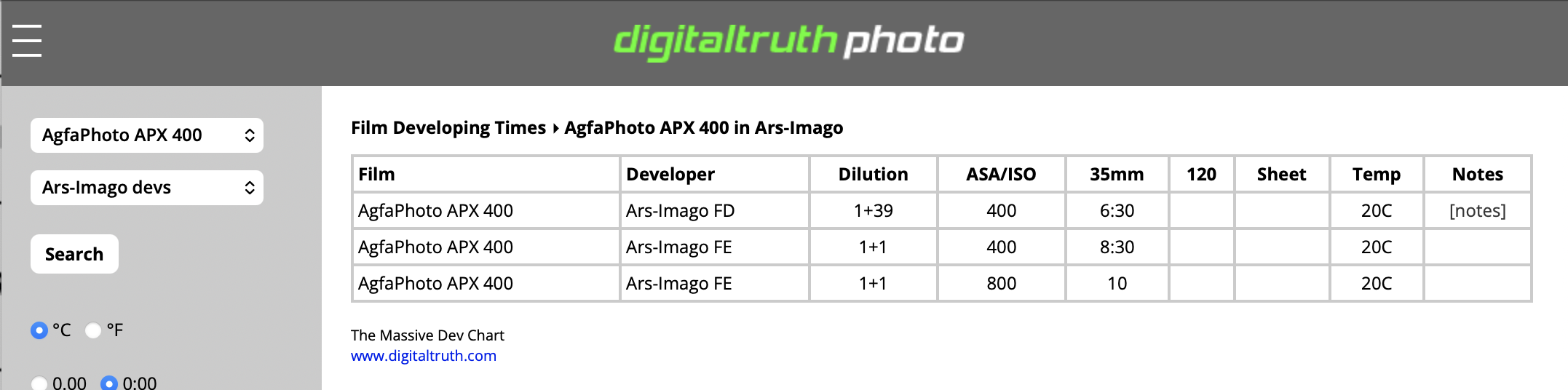

I assume you have downloaded the Data Sheet from the ARS-IMAGO FD FILM DEVELOPER website, right? The ARS-IMAGO Data Sheet does not give a recommended developing time for AGFAPHOTO APX 400, but it does give a time for Kentmere 400 -- which some people say is the same film. For Kentmere 400, when exposed at ISO 400 and developed in ARS-IMAGO FD diluted to 1+39, the recommended time is 6'30". This matches the time given by the Massive Development Chart for your film, so that's probably a good place to start as the normal recommended time. (As mentioned above, you may want to use a shorter time.)
Notice the MDC has [notes] for your film; if you click on the notes, it says "Agitation: continuous first 30 secs, then 5 secs every 30 secs" -- which answers your question about "How many times do I have to shake?"
The The ARS-IMAGO Data Sheet also tells you what kind of agitation they recommend, which is similar to what is said in the MDC notes.
