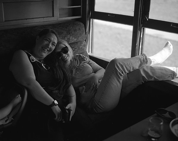

I'm quite happy with the negs. My friend admitted to being a bit drunk when he took the photos so exposure is all over the place but this is probably the best one. Nice highlights which could have easily blown out and decent shadow detail. This is a quick scan, will be interesting to see how they print. Thanks again Andrew.
Well, the photog caught quite a range of highlight to shadows quite well. It has given me real hope that D23 is more than just a box speed developer

So Markbau your negs at the same speed as your friend's and in the same developer and time came out OK -ish but your film was way underdeveloped. It suggests that something was in fact different on the two occasions. Is there any detail in the shadows on the neg in his shot of the 2 ladies. It is difficult to judge from a scan and exposure-wise it looks as if the film was having to cope with a massive range of light
I am not sure that from what I see that D3200 at 1600 in D23 is necessarily a bad combo although it may be that diluted 1+1 is pushing its boundaries a bit
I am not sure that from what I see D3200 at 1600 in D23 is necessarily a bad combo although it may be that diluted 1+1 is pushing its boundaries a bit

I can only guess that the image I scanned of the two ladies was given much more exposure (effectively rated at 400 perhaps) than the 1600 I gave my film. That's the only conclusion I can come to based on the decent shadow detail in that image. The two films were developed identically. I would be interested in finding out how people are exposing and developing their film to produce good negs in daylight conditions.
My instinct and that is all it is i.e. based on a feeling only, is that I doubt if it was exposed at 400. That's nearly a stop and a half down on its "true" speed, assuming that is 1000 and not a little higher. I'd have expected the shadow to be more open at 400 and the highlights to be more blown than they are in your friend's shot of the 2 ladies
