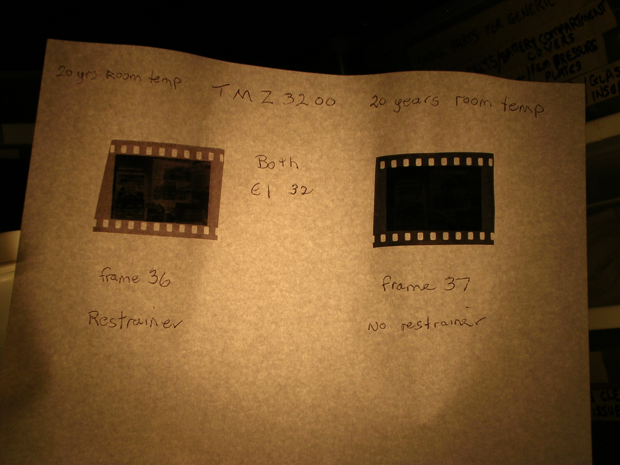

The image represents (though my low tech efforts) how TMZ 3200, room temp for 20 years, can be revived, as long as you are willing to rate it at EI 32 (or thereabouts). My working solution ratio was 3, 4, 3, 0 and the development time was 8 minutes. The right frame was developed normally at the same EI 32 exposure.
Prints are even easier to do. Follow my guidelines and do not be afraid to experiment; don't be afraid to touch up with highly dilute Farmer's Reducer after fixation to enhance the whites even more. (But, unless your paper is bad as can be, you will get bright prints using only my formulae.) If you are still getting too much base fog, use a higher level formula. If you are getting only a little density, give more exposure to your print. With age-fogged papers the trick is to see how much devlopment you can give without getting intense base fog. A little is OK as Farmer's will save the day (as long as you remember to give more exposure in order to counter the reduction in print density from Farmer's.) My Farmer's is as follows: BLEACH: 3 mL Potassium Ferricyanide in wtm 200 mL. FIX: about half strength film fixer, previously unused. Mix 1 + 1 PLUS as much water as you have determined will do the job. A typical mixture that for reduction of base density is 1 bleach + 1 fix + from 0 to 9 parts water. Any of these dilutions will work, but time will determine how fast you want it too work. The ideal timing is about three to five minutes, agitate continually. Remember, this stuff when mixed will not last more than 15 to 60 minutes, depending upon strength. Experiment with SMALL SMALL quantities with one square inch sections of paper for tests. We waste so much paper, film, chemicals. David Lyga is decidedly frugal (but not cheap).

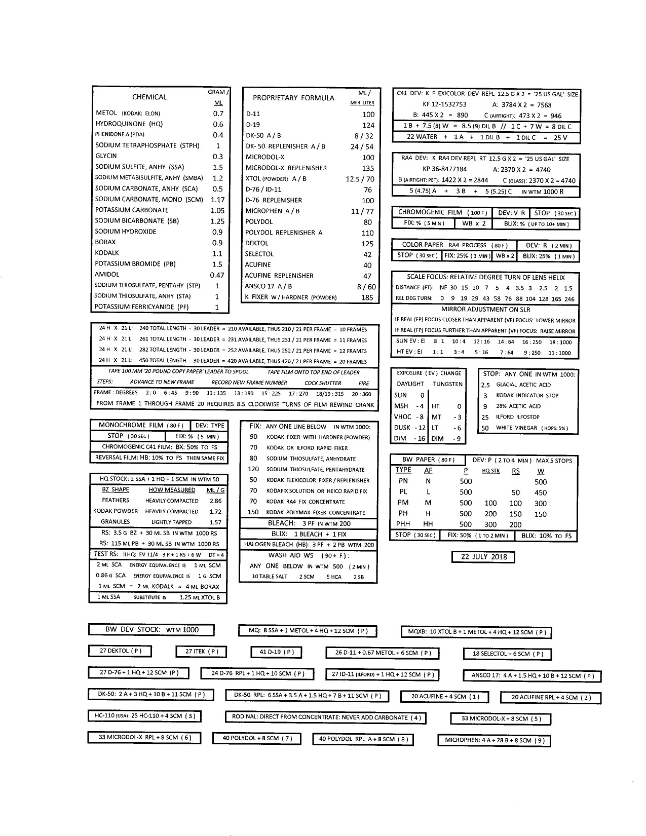

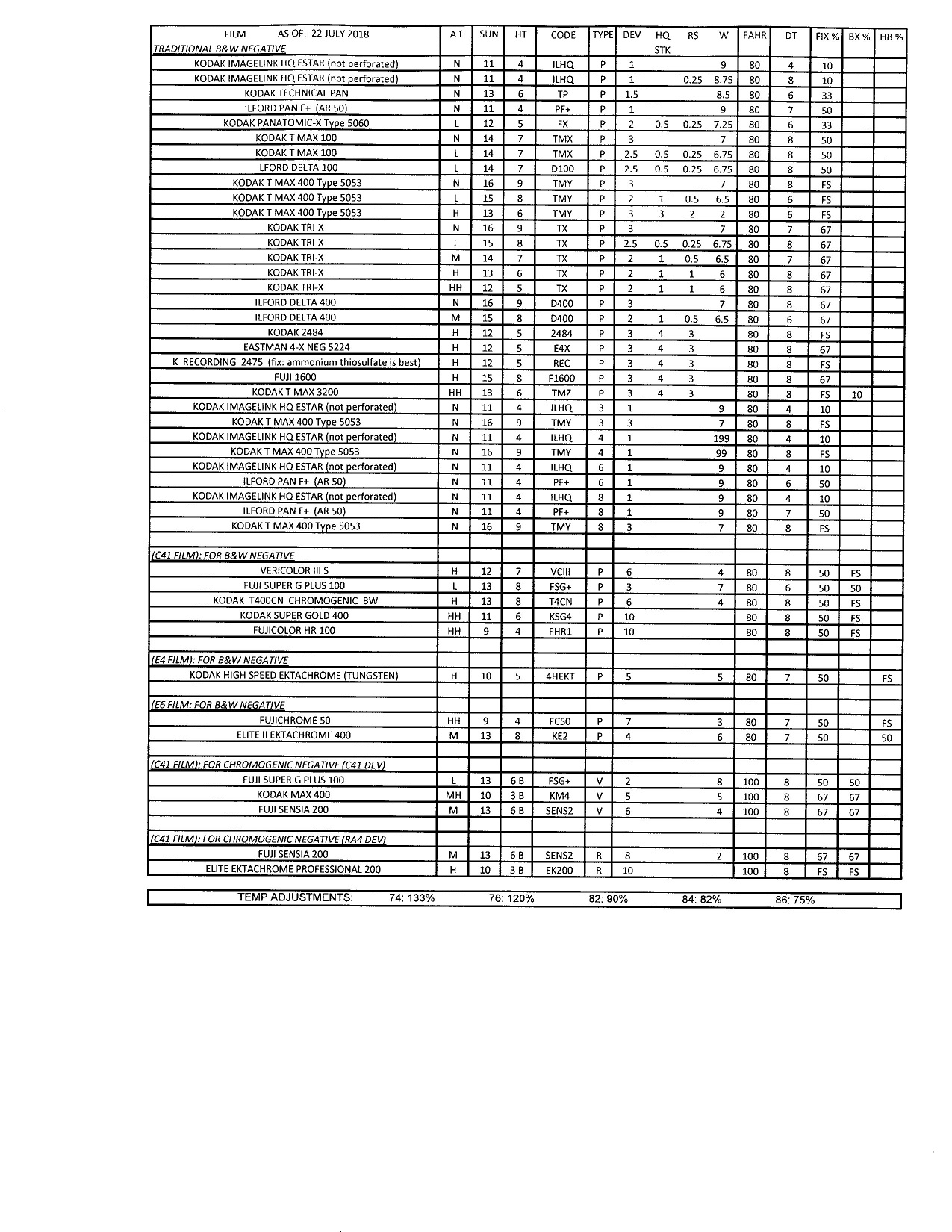

Later, when I get to a scanner, I will post my updated 'photo data' sheets, for the express purpose of driving you crazy. This will represent decades of experimentation and is represented by common sense, as defined by David Lyga. My dilutions for developers, stop bath, and fixer, are amazingly criminal, in a prosecutorial sense. - David Lyga
Here are my photo data sheets just updated. Read them if you want to torture yourself. NOTES: everything is in mL unless specified. Also, I rate film by the exposure values needed for either 'sunlight' or 'high tungsten'. Thus, for example, fresh Tri-X is rated 16 for sunlight, meaning EI 250. For bright indoor tungsten light it is EV 9. - David Lyga
NB: If you wish for a better copy via excel attachment to your email, contact me.

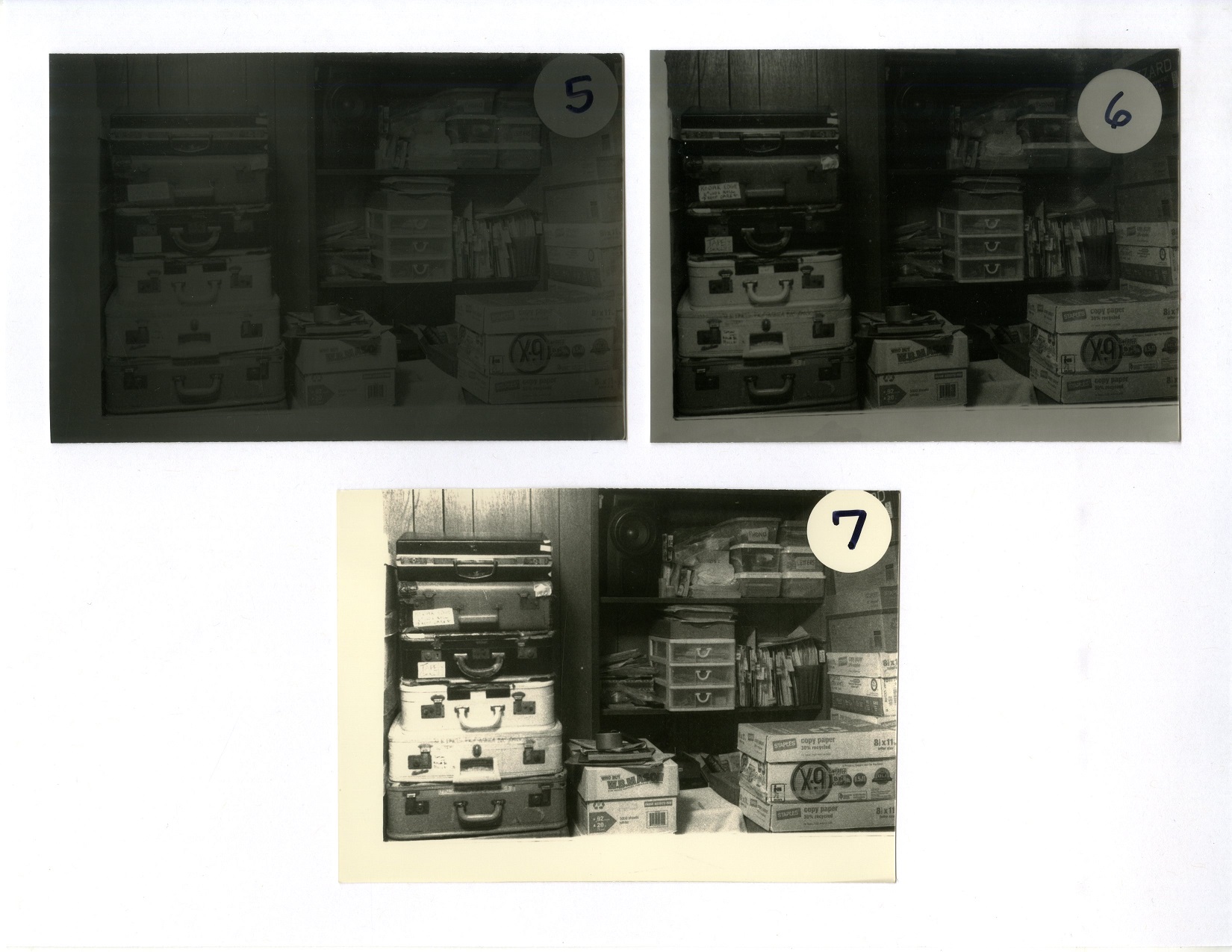

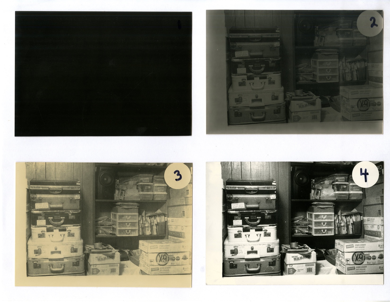

PRINT TEST:
First things first: from now on, let's use "P" as the term for "dev", as P is the designation that I use on my photo data sheets. Thus, the film and paper formulas' format is now: P, HQ, RS, WATER.
OK, for this print test I decided to use an HH paper that is so bad it should be arrested for being obscene. This X-rated garbage is so disgusting that even the reverse side is now strong buff-yellow (like an old newspaper) and even the emulsion shows some occasional streaking. It is the familiar Ilford Multigrade II RC and must have been lying on someone's hot radiator for five years or more. I doubt that any of you have ever experienced such detritus and, no, Simon Galley, you do not have permission to sue me, especially when I state that fresh MG is one of the best papers extant. Thus, I begin with something so terrible (that you will never have to use), in order to prove a valid point.
For this test I used the original negative from the HH TMZ 3200 film shown in the first image that was developed in my HH film formula. Thus, what you are about to see is HH film printed upon HH (really HHH?) paper. With no question, this is a marriage transacted in Hell. Remember, carefully, this technical caveat: For both this film and this paper, the printer is allowed use of only the shoulder area of the Characteristic Curve. The rest of the Curve is buried in age-fog. That says a LOT.
Here are four prints, each made at about 4X magnification. Each had a penny placed onto its top-right corner in order to provide a tiny area of the emulsion that received no light exposure. This circular area demonstrates the extent of age-fog for that particular formula. I did not state this previously, but with intense paper fog you must give more development time, up to four minutes total.
FIRST PRINT: processed in my 'standard' formula, as if the paper were considered brand new. (You remember the formula: 500, 0, 0, 500.) As you can see, the image is almost completely black, but if you look very carefully you will see a facsimile of an extremely faint image. Maybe this will not manifest in the scan, but it is faintly there and can be barely seen if the print were held in your hand. Exposure was 2 minutes at f8 and the quality is genuinely disastrous.
SECOND PRINT: processed in my HH formula (500, 300, 200, 0). This is my best attempt, with needed developmental density forcing fog to manifest greatly in the competition for differentiated density, but showing an image that is at least readily visible (albeit one that is bad, and of low contrast). Few would have been able to get even this far with this terrible paper. Exposure was 3 minutes at f8.
THIRD PRINT: HH formula, again, but with one stop more exposure. After fixation, a few minutes in dilute Farmer's Reducer allowed the print to begin looking halfway decent. Exposure, a one stop increase to allow for the Farmer's reduction, was 3 minutes at f5.6. With this attempt, the quest for contrast was desperate and the combination of the HQ, RS, Farmer's, and adequate exposure and development time seemed to bring somewhat positive results . But, don't downplay the second print's merits: to achieve even that paltry amount of contrast was amazing for the given paper. However, this third print I consider to be the eighth wonder of the world. Notice that the right edge is washed out because of streaking; the emulsion has an embedded inconsistency. Who knows what that paper previously went through? With this 'worst case' paradigm presented, merely M or even H paper should pose no problem for obtaining presentable prints. That might be stretching it a bit with regard to H paper, but you will be amazed at what you can obtain if you experiment with exposure times, development times (2 to 4 minutes).
FOURTH PRINT: To set the record straight, I wanted to show a good print (on a relatively good paper) from an HH negative. I printed this HH negative onto Adorama VC RC paper which was hanging around at room temperature for 'only' about a dozen years. It is lightly age-fogged, but for David Lyga THAT is brand new paper. Often, when I print with L AF paper I don't bother to use the L formula. Instead, I process normally (500, 0, 0, 500) and use a very dilute Farmer's after fixation, in order to clear the base and brighten the whites. I did this here. What I wish to emphasize is that the exposure was 10 seconds at f5.6. This is four to five stops less exposure than the second and third prints had received. That extreme difference in paper speed is a point that might not be readily recognized. The addition of RS robs sensitive materials of speed, plus, like film, papers lose tremendous speed as age-fog progresses. You need this added exposure density in order to make up for the reduction in development density caused by the addition of RS, as well as for the age.
A lesson to be observed here is that my standard paper developer uses Dektol at a 10x dilution (at 80 Fahr). Few will heed this directive because the literature says not to believe such nonsense: It says "you MUST use Dektol at a 1 + 2 dilution"; (indeed, to defy such instilled mandate is to ask one to re-enact the Spanish Inquisition). Remember: P = Dektol 1 + 4. Then, the added 'same volume' of water for my standard paper formula (500, 0, 0, 500) turns this 1 + 4 effectively into double the dilution, or 1 Dektol + 9 Water. Admittedly, this high dilution leaves no leeway and, if adhered to, you must not cut corners. In other words, if the temperature is a bit colder than an ambient 80 Fahr, and/or if your standard development time were to be, say, only 1.5 minutes, you might start seeing compromised blacks. But if strictly adhered to, the dilution is adequate to give a full black. Obviously, as you can see, it works, despite hearing from those who say it can't work. (At least TRY to understand that, when thinking about such technical matters, proof is more important than passion ). So, you see, a first class print CAN be garnered from HH film, and, just as importantly, at a Dektol dilution of 1 + 9 if the paper evidences little inherent age-fog. (However, "'one-shot' or you will be shot" becomes the absolute maxim against reuse.) And, in addition to yielding a negative that is able to be printed more easily, the HH film development, with all that RS, reduces the grain. By the way, I routinely use fixers at about half the 'required' strength. In other words, I use paper strength fixer for films (yes, even T MAX) and half paper strength for papers. You CAN reuse these diluted fixers as long as you reuse only a little. Stop baths (STRICTLY 'ONE-SHOT') I dilute greatly: 2.5 mL glacial acetic (or 9 mL of the 28%) per liter. This high dilution stops development in its tracks and COMPLETELY obviates the fear of 'pinholes' in the film. Sometimes common sense is more important than anything.
I do hope you have learned from this episode that sometimes, with much persistence (and a bit of madness), blood really can be squeezed from a stone. It is not so much that I am inclined towards saving money as it is that I am obsessed with going through life dealing with the worst scenarios beforehand, and then allowing 'normalcy' to be experienced as a delightful bonus. This has allowed me to survive for the 68 years in which I have experienced much personal enmity. If you want quick answers that I might be able to help you with, you may call me (as some have, already) at 215.569.4949 (mobile is 215.820.1560 but please try land line first).
My new Avatar (taken two days ago) is quick to demonstrate that it is not only this paper that is showing its advanced age. - David Lyga

PRINT TEST:
