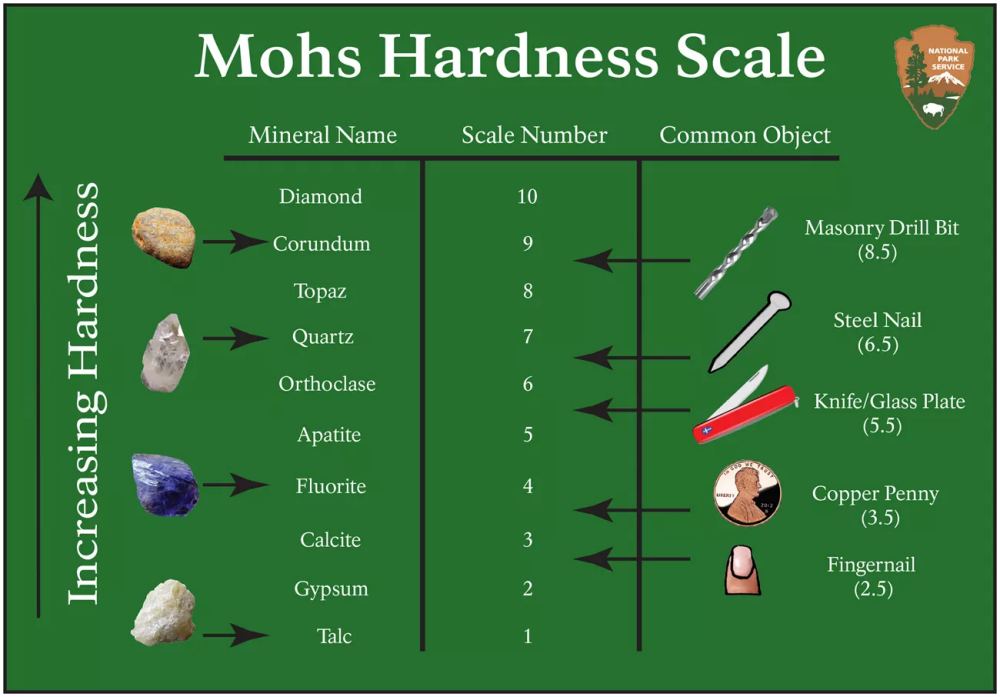

I'll bet he is referencing two of the entries on the Hardness scale.
Perhaps my English isn't good enough. The lens coatings that I use " hard/soft" is because how it is called around in my place. Older coatings (like single coating made in 1950s, or some that could be easily scratched or mess up ) is considered "soft" . On the other side " Hard" is more like modern coatings that could even handle alcohol cleaning without issue.
And this is how and what exactly happened. I got a 58/1.4 and I checked, obviously it has been opened before me (from checking the retaining ring marks) , cleaned once leaving a thin haze. But now I am asked to help remove the fungus and so I not sure to try, or take the risk.
This is what the reference is to:

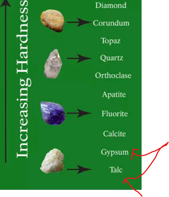

A follow up here.
I am now very sure about this scale . But here I tried tested it with Fuji lens cleaning fluid at the corner with lightest touch, after dry it left a slightly post-cleaning mark there. It is not from the glass but from the coating when checked with scattered light. 🤔
I gave up and just returned to the original owner .

"Hard" and "soft" in coatings doesn't really have anything to do with the Rockwell or Mohs hardness scales - you can scratch any glass lens or thin film with a sharp object if you try - and I think it was a distraction to bring that up.
Thanks for brining this up! I thought the terms I used in here is exactly same as the people here 😅
