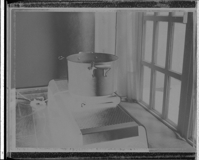

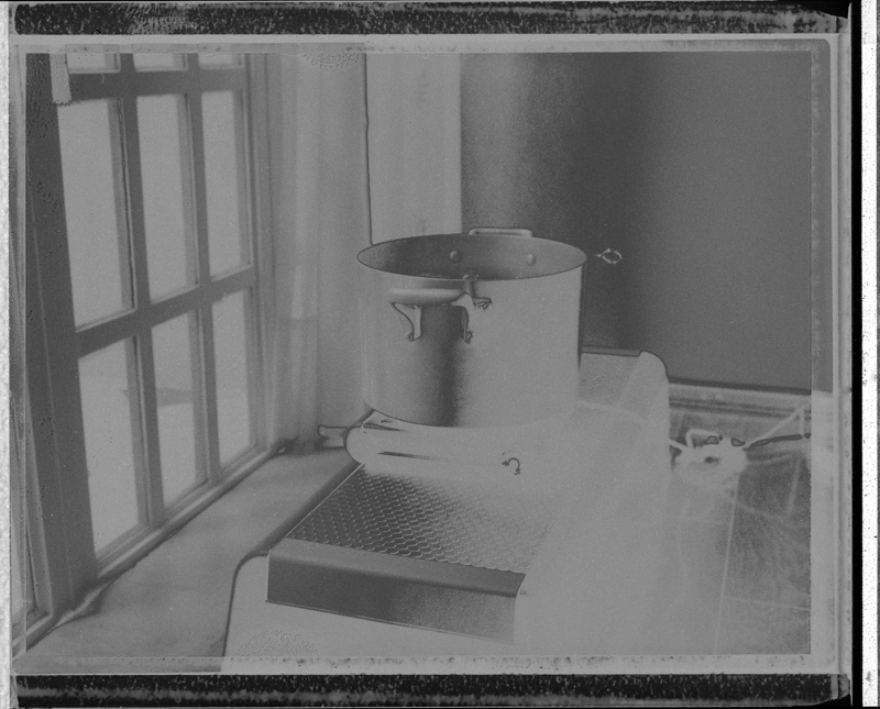

I decided to work with Fuji FP-3000 B for a new project, this is my first experience with this material. I expose the first print at the Fuji settings, 3200 ASA develop 20 sec at 21º C and it came out high contrasted, so I make another shot with the same settings to be sure that there wasn't an error. The result was the same. I develop the third film for 5 seconds more and no noticeable changes occurred, just a slight increase of the detail in the high lights, then I increase the exposure rating the film at 2500 ASA, etc. I go through the whole pack increasing the development and exposure and get no good print, one with a reasonable range of tones.
Any suggestions? is this film high contrast? there is a way to test it to find the desired contrast?
two scans of the best results:

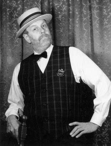

I have indeed found FP-3000B to be inherently high in contrast. My absolute best exposures were with my century-old, uncoated Wollensak Velostigmat lenses. On film, these lenses render quite low contrast; on the Fuji instant film, they were pretty well balanced. Here's an example:
Your scenes look quite high in contrast to begin with, and I can understand how the Fuji prints might accentuate that. Have you tried it in low-contrast situations?

They look too dark to me. I'd increase the exposure.

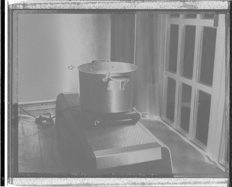

I think I have a good result rating the film at 2500 ASA, and develop less, 15 sec at an ambient temp of 21º C.
@hsandler, I'll try the negative scan method. Observing the negs I'm thinking that if I peel them from it's base, if it's possible, I can mount them in a black plexiglass and made a sort of "instant film amprotipe".

That last one looks much nicer! If you're still looking for less contrast, though, I second trying to scan the negatives. I played with scanning them before and they seemed to work quite well.

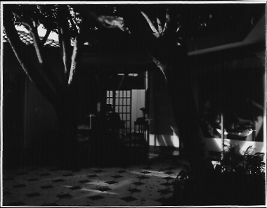

After another pack of ten prints I found out that following the earlier quoted Ansel Adams's motto, "expose for the shadows...", I get a more desirable contrast. The key for what I'm trying to do is to place the zone III correctly. The film has a very short dynamic range, so it's easy to fall in a very contrasty image if you misplace your zones, and there is no room to alter the developing process, at least as far as I know.
The whole exercise allowed me to catch up on the practice of the zone system, I get my Pentax spot meter out of my gear cabinet after some time of no use.
Here the more recent print:
