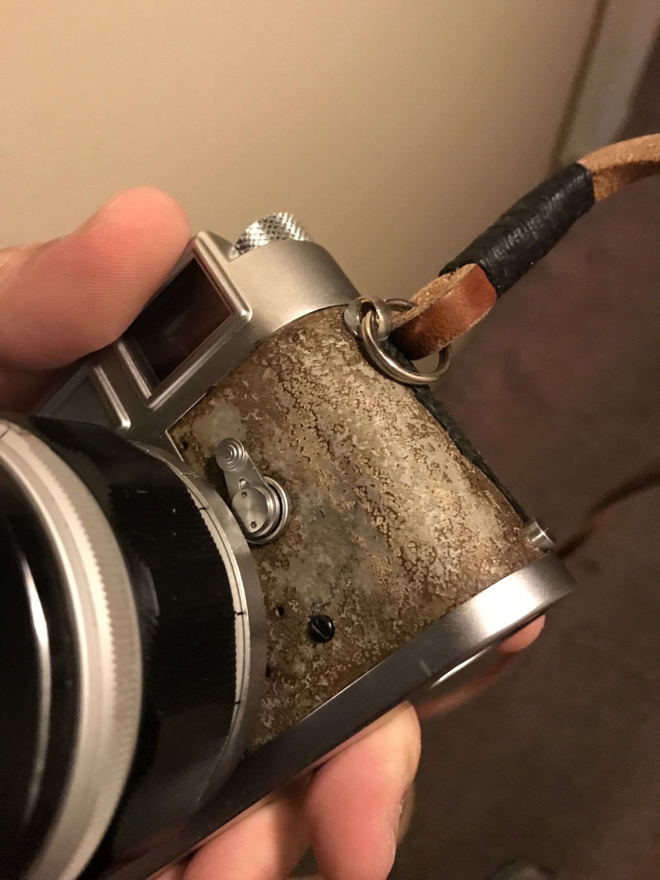

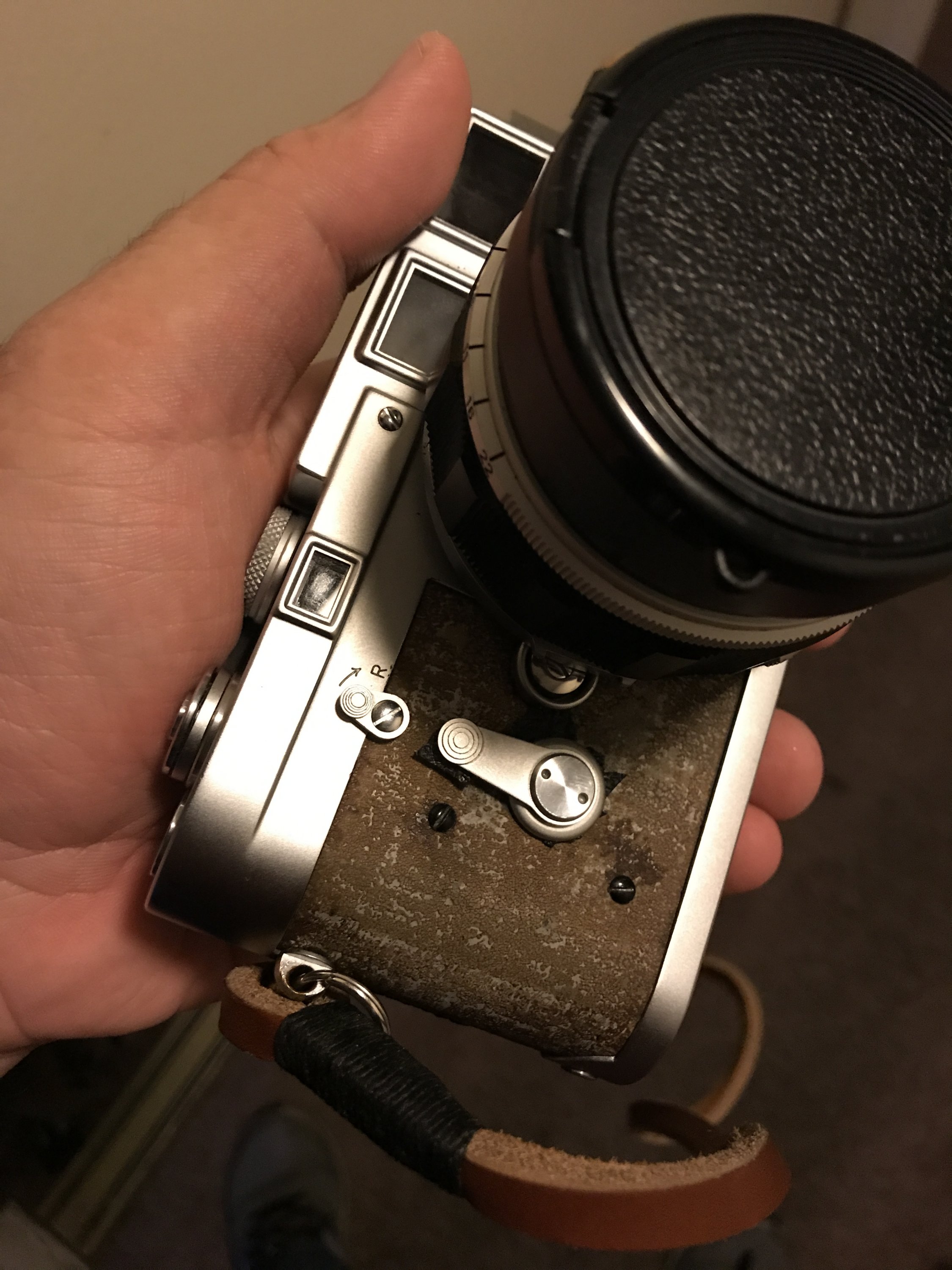

So when I got this M3 the leatherette was in not good condition. Tried to peel it off and it came in chunks. How do I chip off the remaining leatherette? They seem pretty stuck. And how do I clean off the brown/black stuff, I don't think this is rust.

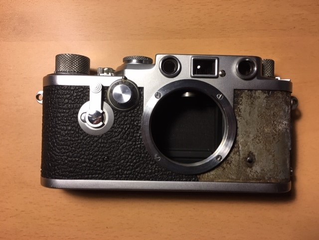

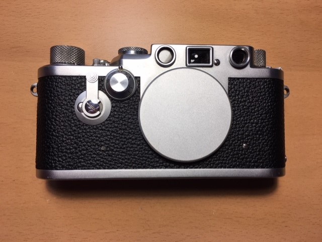

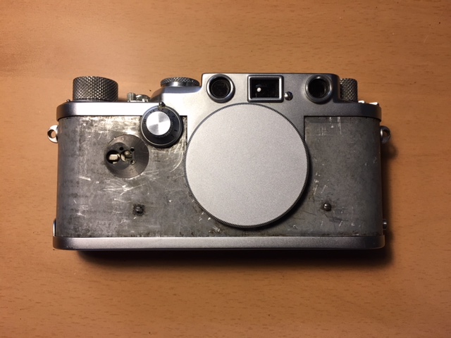

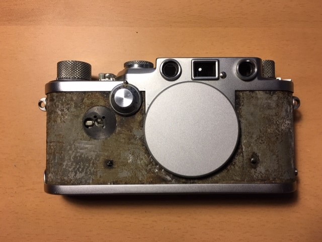

some photos of one I recently re-skinned. On this one the old skin flaked off pretty easily.

Thanks for all the replies, used a sharp knife to carefully pry off the remaining vulcanite, worked like a charm. Will find something in the hard ware store to remove the glue tomorrow.
