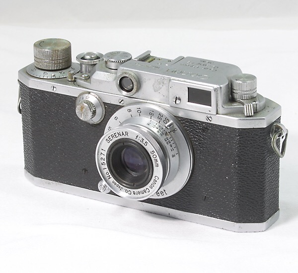

I’m in the restoration mood again and I’m considering grabbing a very old and fairly rusty rangefinder for super-duper-dirt-cheap and bringing it back to life. However, if you take a look at the photos below, does this seem like a camera that I can doably restore and clean? If so, what’s your opinion on the best way of doing that without damaging the camera even further?
Look forward to read your responses. Thanks!

Are you looking to just do general clean up or wanting a full resto job? That chrome needs to be re-done, if for the latter.
Those early style Canons are pretty accessible, otherwise so yes, a good option. If you haven't opened up an RF before, a cheap broken Kiev or Zorki could be a good first step and less to cry over if things don't go smoothly.

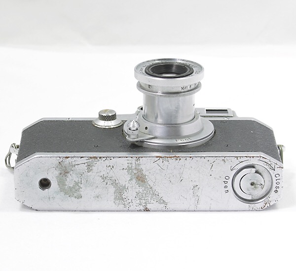

The brown color you see is not rust (most likely) it's the brass base metal showing through the chrome plating. Some metal polish will brighten things up, and you will have shiny brass and chrome. As Fixcinater says, if you want to restore it to unblemished chrome you will need to remove those pieces, then the chrome can be removed and redone.
Yeah, post war plating left a lot to be desired. Like the others said, replating would be the way to go.
Of course, with the chrome removed, it would be a candidate for a repaint job, Most paint available won't hold up
but I've been thinking about firearms paint may be a good candidate. I think a weapon may be a little more roughly that a camera.

Just buy another baseplate- they are usually cheap.

You can use Windex on a soft toothbrush. Don’t use any lens cleaner containing ammonia to come into contact with the lens. It applies to lens coatings made and to naturally bloomed lenses.
You can do automotive chrome polish. If it won't get it out, the only things you can do remove the chrome and get the part re-chromed.
