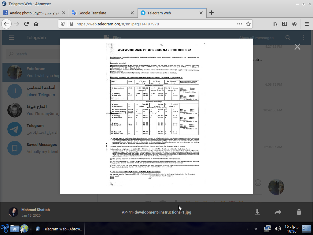

welcome everybody
I would like to thank my Greek friend Anon Ymous for his encouragement and patience with me in explaining the details of the manual re-exposure.
Raghu Kuvempunagar And I thank my Indian friend for his great dedication in providing lasting support
I thank my American friend Donald Qualls from North Carolina for his constant encouragement and great patience in responding to inquiries.
I thank from the bottom of my heart my professor and permanent teacher, the respected engineer Rodolfo Rudeofus from Vienna .. God bless him. I thank him for his patience for my stupidity and to calmly deal with my scientific potential, with great patience, lack of despair and great perseverance, and this man will not be able to fulfill his right of words of thanks and praise throughout my statement.
The process test (AP41) passed as you saw it in a dream.
WYSIWYG Display results with a separate post
Many thanks to the Ukrainian colleague who brought this version of the great Russian books
Mr Vovanuhc
Jul 28, 2016
2,803
India
Nice! Which film did you develop in AP41 process? Somebody previously reported that Provia gives good results in this process though it's hard to conclude anything just by looking at the scans posted.
mohmad khatab
mohmad khatab
Sep 8, 2012
1,228
Egypt
Kodak Film (E100) 120mm - Expired - I do not have any picture that I can view now ,,, since the film is 120mm and there is no way to scan now, but I can take a picture on the mobile if it matters to you a lot
mohmad khatab
mohmad khatab
Sep 8, 2012
1,228
Egypt
My Greek colleague
My American colleague
My Indian colleague
My Austrian colleague is currently unavailable and is in Greece to spend his annual leave with his relatives and I cannot communicate with him at the moment.
On the whole, the AP41 appears to have succeeded, as Mr. Ron Mawry expected.
- Yes, he said that before his death.
- He said that the German developer (T32) is = (CD4) at 98%. Indeed, his expectations were correct.
- I will show you the results later,
But I am currently in the context of the main topic of this post.
- Manual re-exposure using a lamp, she succeeded with me in two pictures and when I tried to develop an entire roll she did not succeed with the image I was looking for and left a rather blue fog ,,,
After that, I prepared a re-exposure solution for Fuji formula, the insulation material was modified, and Calgon
Everything works great and great.
- But the basic idea of this post, is how to incorporate fluid (re-exposure) into a color developer.
- I will wait until I hear some advice
< Reversal solution>
Calgon.... 3.0 g
Stannous chloride dihydrate 1.0 g
p-aminophenol 0.1 g
Sodium hydroxide 8 g
Glacial acetic acid 15 mL
Water to make 1,000 mL
pH 6.00
  • AGFA-Process-41-recipes.pdf
  • Screenshot at 2020-07-15 18:36:42.png
