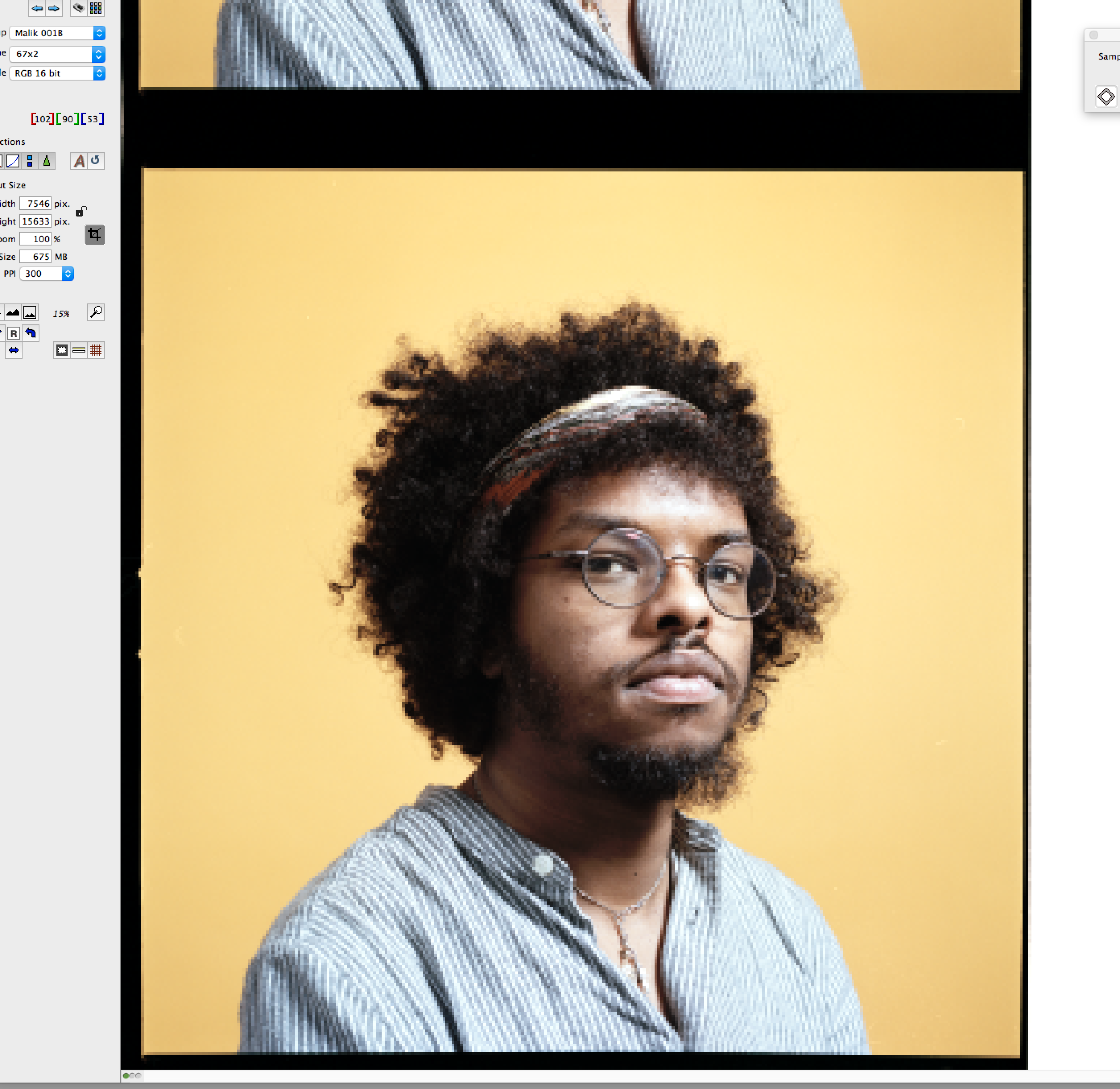

I've inserted a photo to show what I mean about the pixelation. You can see that I've scanned two frames, but I can't get the second one to show up clearly so I can produce it in FlexColor with any effectiveness.
As for the photoshop error, I've always been able to change it bback to the original and then save the file, so that's not a problem. I was just referring to the idea of taking the photo into PS, breaking it apart into smaller frames, then saving, which would all simply be done because I can't get a good preview from scanning multiple frames (as seen in the attached image).
