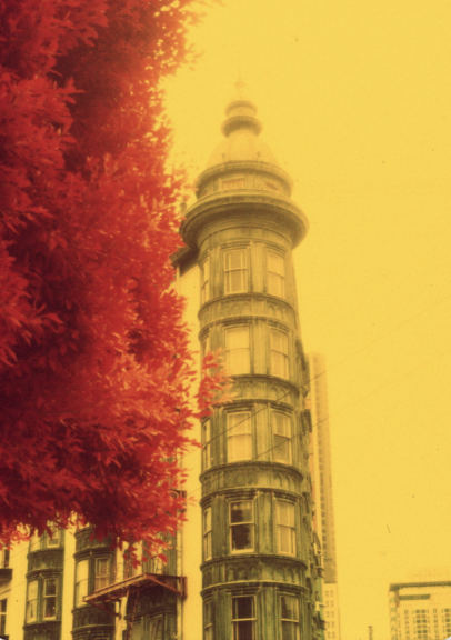

I shot the first one a while back, and a lot of the photos had yellow tones like this one:

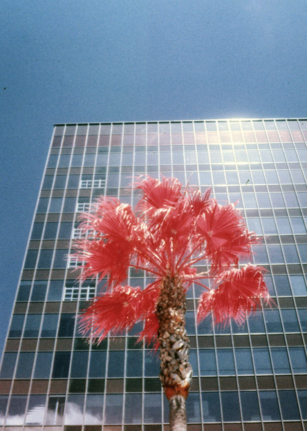

And some photos produced a better result like this:
I don't remember if one of them was cross-processed and the other one processed normally.
How can I make sure that my results look like the image on the bottom, rather than the top image while shooting and having the film processed?

Were you using the same filter throughout the roll? A red filter will cause a color cast, like the one in the first image. An orange 16 filter should give colors, like the second image has.

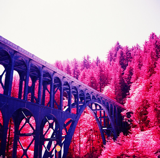

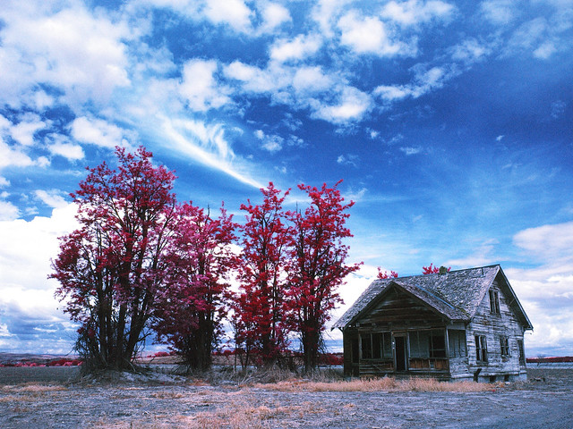

I shot these with Kodak Aerochrome Infrared film using a yellow filter and never got yellow like that. Did you use a different filter or no filter? Infrared film is best with bright sunlight from behind you, could you have been facing in the direction of the sun? Cloudy day?
High Desert Farm House by Bryan Chernick, on Flickr
This one has clouds making the sky white but I still had bright sun from behind me.
Cape Creek Bridge by Bryan Chernick, on Flickr

Thanks! Yes the first one was a cloudy day and probably a dark red filter which made it yellow

Using a red filter on color infrared film will just screw things up. It will eliminate the blue light and the green light, so you get no blue dye, so your images have a yellow cast.

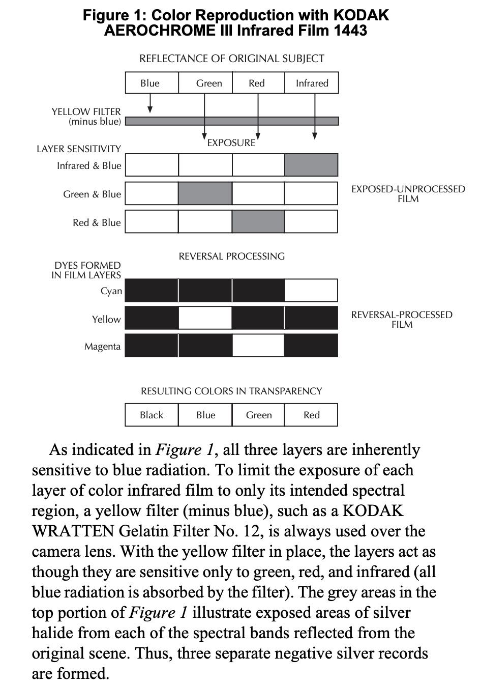

A couple of useful resources are the Aerochrome datasheet at https://125px.com/docs/unsorted/kodak/EN_ti2562.pdf and this page: https://www.analog.cafe/r/kodak-aerochrome-a-colour-ir-film-guide-and-review-uwi3 Fig 1 from the datasheet shows a sort of flow chart of how different wavelengths of light expose different layers of the film and the resulting colors. It also explains the use of the yellow filter.

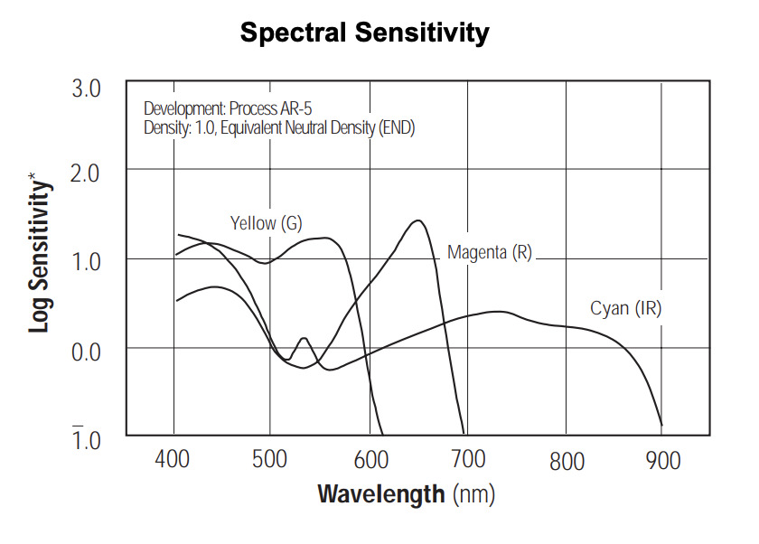

Figure 2 shows the spectral sensitivity of the different color layers. We can see that the layers are all very sensitive to blue, which is why the yellow filter is needed. However, a red filter would also cut off the layer labeled "Yellow (G)" [yellow dye sensitive to green light], which forms the blue areas when reversal processed.
Thank you so much for this insightful answer. So to make sure I understand correctly, if I want to have results that look like the picture of the palm tree, I should use a yellow filter and process it in C 41 chemistry, correct?

No, you follow directions on the film and process it E-6 or AR-5. I have no idea where you'd find AR-5 processing, so you would process it E-6.
Yellow #12 filter, process E6.
IIRC, AR-5 processing was pretty close to E-6, but optimized (contrast, et al) for the type of exposures - aerial - that the film was designed for.
