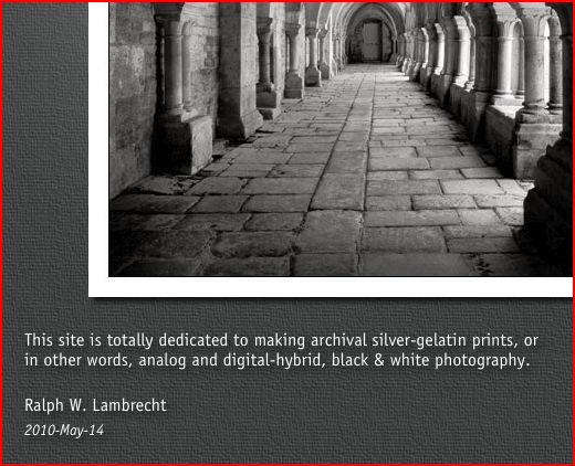

I'm glad to hear that you like the church pictures. Let me tell you how they were taken and made to clarify that there really is no 'magic' involved.
1. all taken on Tmax-400 (EI 250), developed in D76/ID11 1+1
2. they are a mixture of 6x6 and 4x5
3. exposed for Zone III, developed for Zone VIII
4. printed on grade 2-3, Ilford Multigrade IV-FB
5. appropriate dodge and burn for all of them
6. extra burn-in for windows through a custom mask
7. toned in selenium and sulphide toners
8. custom spotting for all prints
7. scanned and digitally corrected so highlights and shadows fall on 4% and 96%, respectively
8. no other digital manipulations
There is one very important message for point 3 above. The Zone System should not be used to always 'catch' the entire subject brightness range. If you have a single bright light (such as a church window), and you make it part of the Zone System work, it will push all other tones down, and you will lose the midtone contrast. I ignore bright highlight features, and let them go where they want to (sometimes Zone XI or above). It's easier to burn them in with a custom mask during printing. Tmax can handle this overexposure, because I don't develop it with a highlight roll-off (shoulder), which would compress these highlights. It's indeed as you said, almost like having two exposures on the same negative.

oops i had no idea you would take offense to my post. oh well its been removed so nobody will even know what i had written Capture.JPG
this is why i mentioned digital approaches
i believe that this statement is a little strange
