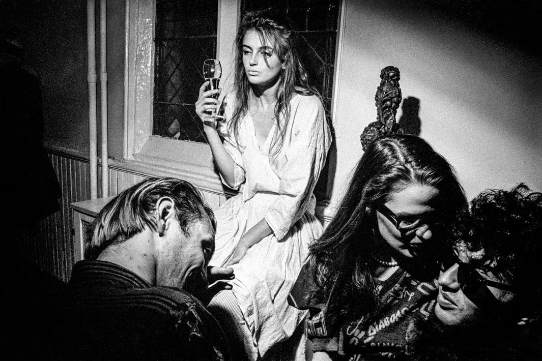

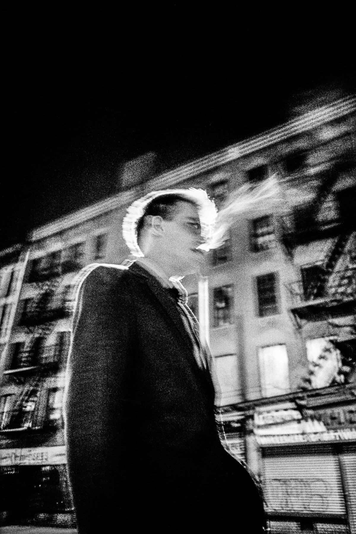

I've seen some photos from Ken Schles's Invisible City series. My question is, how can I achieve something similar to this look with 120 format film? Do I need some high-contrast developer or can I use D-76?

Welcome to Photrio! Great question. Lighting has a lot to do with the contrast in the first photograph.

The grain in the positive is a map of the "spaces" between the grains of the negative. For those "spaces" to well separated the negative should be dense.
Sharp edged grain is enhanced by using a non-solvent developer like Rodinal, not D76.
Grain and contrast are both exaggerated if those dense negatives are printed on contrasty photographic paper.
I get detectable grain from 120 format Ilford Delta 3200 film exposed at EI 800, developed in Xtol-R, and printed to 8x10 size. And I'm not even trying for grain.
Welcome to Photrio!
My first suggestion would be to drop the 120 format in favor of 35mm. You need to resort to extremes to get this kind of grittiness from medium format. Even with Delta 3200 etc. you'll have relatively smooth images compared to the examples you show.
Then shoot a somewhat fast film (HP5+, TriX), underexpose it a bit, and give strong development.
When printing in the darkroom, print at grade 5 and control overall contrast by burning & dodging. In Photoshop etc., use adjustment layers with the contrast cranked up all the way for each part of the image and use selective masking to achieve the same effect as burning & dodging in the darkroom.

Thanks for all the help! I shot quite a lot of rolls of 35mm HP5+ over the past months mostly pushed with 1 or 2 stops and developed in Rodinal and the contrast was high (even when printed on grade 3 paper) but I could never achieve such grain. I don't want to copy him but I like to try different styles for fun.
So in my understanding, if I use grade 5 paper (or VC paper with filters) and I print larger or crop a part of the negative I should be able to get granier and more contrasty prints.
koraks
Nov 29, 2018
22,290
Europe
Yes, this will surely help.
You're on the right track with the HP5+ pushed in Rodinal, too.
@Sirius Glass also makes a valid comment about subject matter; it's hard to get this look from a bland scene, so you'll have to look for the right kind of light. But then again...that's pretty much always the case in any kind of photography!

The standard recipe for exaggeration of grain is under development, allowing the use of high contrast paper. Kind of the opposite of push processing, where extended development of underexposed film allows printing on medium grade paper.

If you want grain with HP5, use FX37. The photo samples look like pushed TriX in 35mm to me. Anyway, you get harsh grain from development.
It also helps to have a lens that's not giving you any softness. So a good coated prime on a rangefinder.
Pretty much everything everyone above has said seems valid to me.
Sirius Glass
Jan 18, 2007
50,316
Southern California
The second photograph is backlit with the hair highlights over exposed to bring out a halo effect. For us mortals several different exposures would be needed to achieve this effect.
This.
You want a very dense neg with low contrast that you can print on grade 4 or 5. I find that works better than just pushing on its own, though adding push processing this will increase grain even more, at the expense of being harder to print.
Starting with a grainy film makes an even bigger difference. Either of the 3200 films is a goog choice.
You will get more contrasty prints, and it probably will show more grain, but the point is that the print still needs dodging and burning which is a skill, it's not a free lunch to make prints like Schlse.
