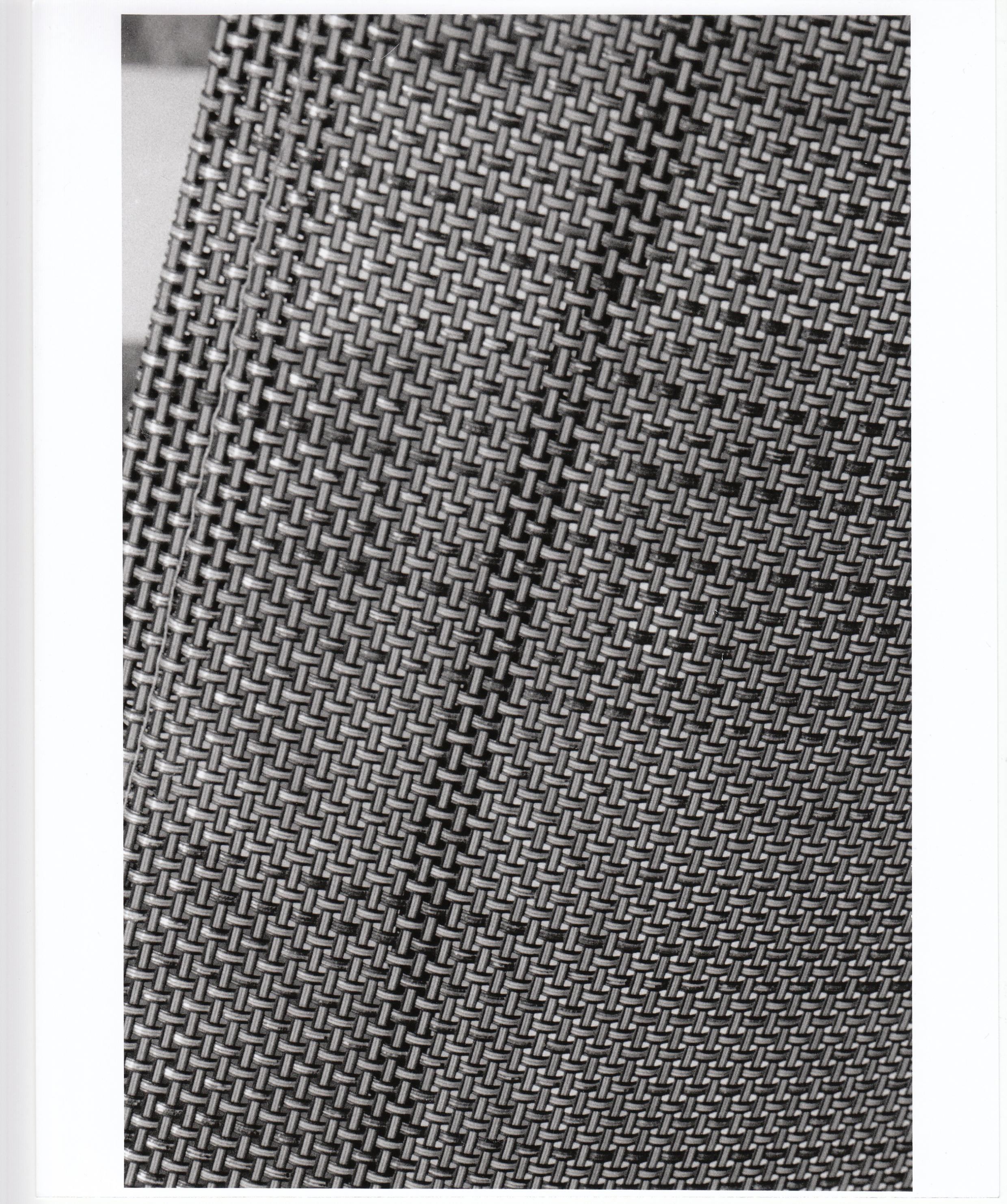

Hi. Is this
good enough for you ? It is a scan from 8x10 print made using 35mm film And this
is a 1/4 of 16x20 enlargement made from the same neg.
Developed in X-Ray film, BM2000 developer.
