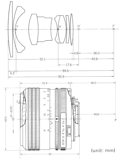

Is this the beast? https://www.mir.com.my/rb/photography/companies/nikon/nikkoresources/preAI70/35mm1.htm

That's basically it, although you attached the ai lens. Mine is much older. But I do recognize the doublet as 3 and 4 from the front
